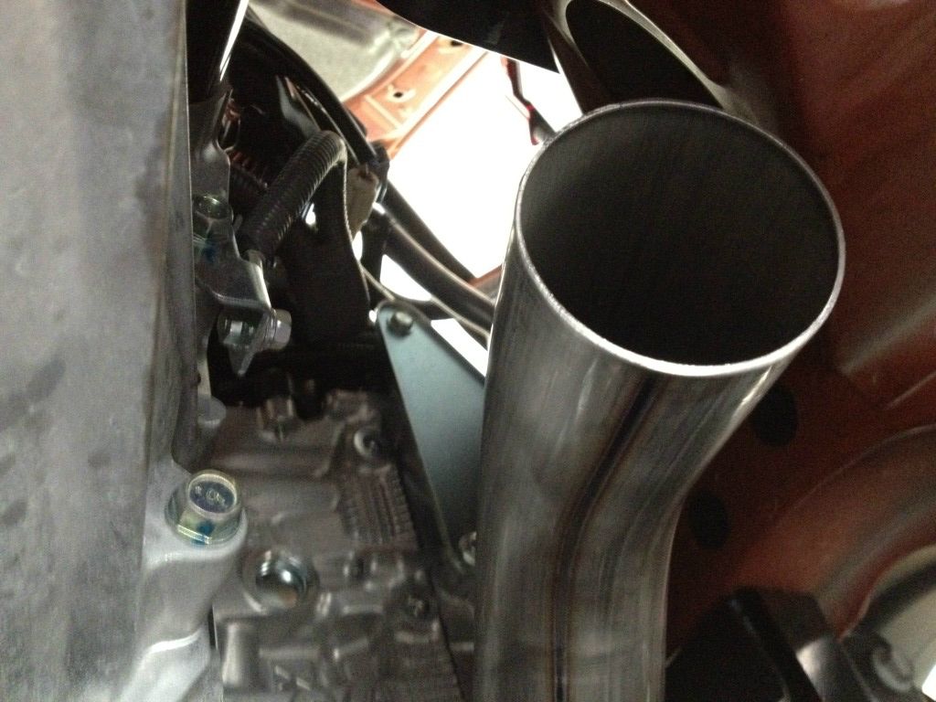

Anyhow the down pipe protrudes about 2-3 inches lower that the original. I have a brz manual vehicle. I'm currently installing my old one so I'll be back in 30 with pics.
[EDIT] Here's the pics

Originally Posted by Furtive View Post
Do you have a brz and it's a manual?
irrelevant. The cars are identical mechanically.
BTW, you need to remove your stock overpipe. You are trying to attach the SRT overpipe to your stock overpipe.
mike is right. You have one more pipe to remove. You need to remove the aluminum splash shield/skid plate to access the connection where the overpipe connects to the header. To make life easier, remove the heat shield from the stock over pipe and you can twist it out. I think someone was able to remove it without removing the heat shield, but it's not easy. I wrestled with it for about 10-15 mintues and gave up and removed the heat shield. It came much easier without the heat shield.
Once the SRT overpipe is connected, it will look like this.

thanks for all the helps guys. I'll probably try it again tomorrow. Thought the overpipe was the header already. I didnt see any bolts. XD Newb move

False alarm it does fit a brz ! A little bit too loud for me but manageable (original resonator ) full review in a day or so.
