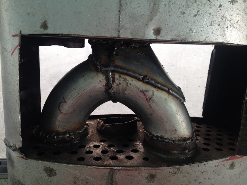

I saw the other thread about the OEM muffler mod,,, so I wanted to add a pic here. I got another muffler and cut it like like the previous one but this time attached the input pipe to both output pipes. It ended up being a 'U' pipe like the previous one plus a kind of a flanged offshoot made of 4 peices of steel. I also covered the perforated pipes on the input pipe. What it ends up being is one input to two 6" (give or take) resonated output pipes. I will say adding the output to that second pipe (passenger side) was a pain as the three pipes are on different planes and it's all really close together.
Doing this also required to open up the other side so I could finish up the offshoot and cut another opening so I could cover the perforated pipe.
Haven't installed it as I still like what I have with just the 'U' pipe. Going to haver to do that though.
