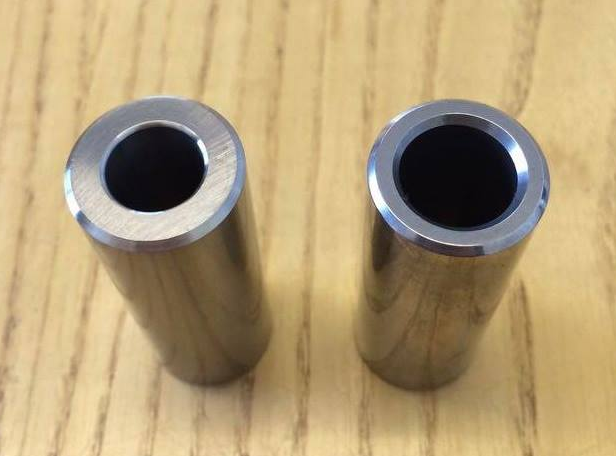

Originally Posted by FRS Justin View Post
are those the thick CP pins I can't tell in the bag but if they are not I would consider the thicker pins.
You have way to much work in this to risk a pin failure or piston cracking from a thin pin.
Sweet build anxiously awaiting results.......
They sure are uprated. Stock FA20 CP pin vs our uprated ones.

Old 12-15-2015, 02:31 PM   #80
spitfire481
spitfire481's Avatar
Drives: 2JZ FRS
Posts: 1,378
Thanks: 97
Mentioned: 27 Post(s)
i have the upgraded JE pins. big difference between them and the ones they came with. worthwhile upgrade
