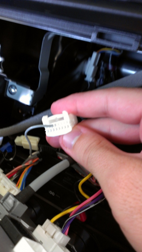

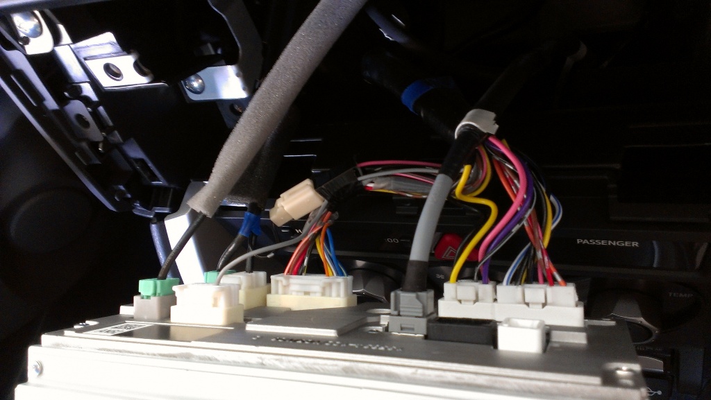

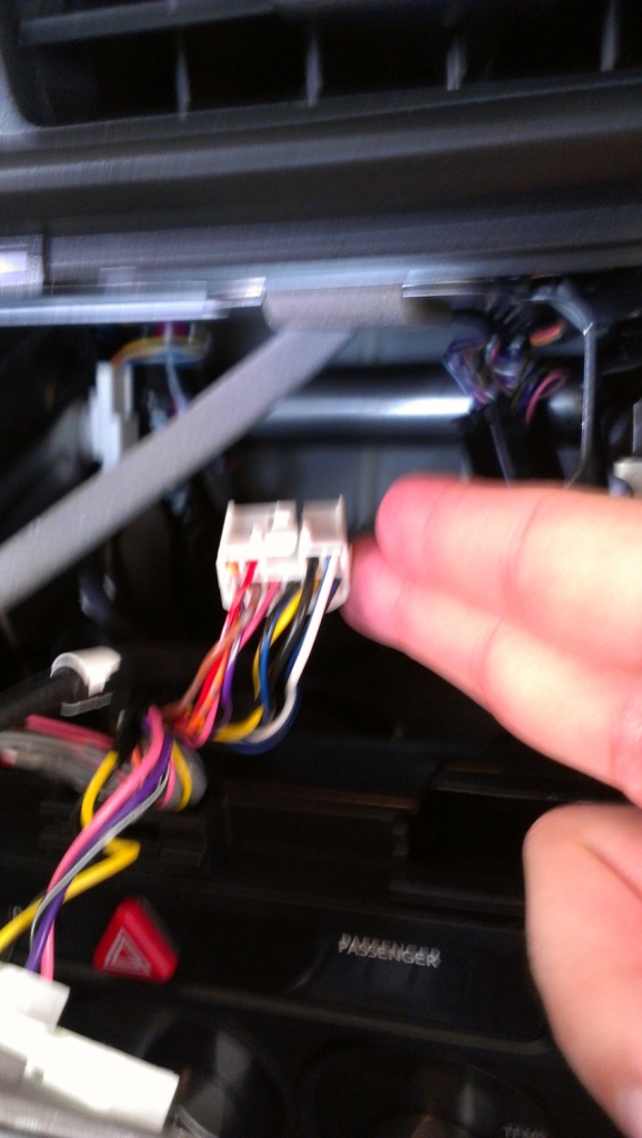

Originally Posted by xcelir8brz View Post
cut the grey wire. tape the side going to the front of the car. with the grey wire hanging from the connector, add a wire to that grey wire and solder/tape. next, take the end of the new wire and ground it to 10 pin connector, pin 7 (on your car it looks like a pink wire), on my BRZ, I think it was black. you can also tell if the grounding works by going to the diagnostics menu under settings, and watch the screen with (r)everse, (p)ark, etc.
You can also find a screw on the back of the headunit, and ground the grey wire there. It needs Chassis ground. OR add a really long wire and find a nut/bolt on the car somewhere behind a panel and ground it there.
Where you ground it is not chassis ground (left of head unit nut) image 98.jpg.
10-pin power/speaker harness
1 2 - - 3 4
5 6 7 8 9 10
(orientation: viewing pins on car's factory plug, wires pointed away from you)
Code:
1 RF+
2 LF+
3 +12V Accessory
4 +12V Battery/Constant
5 RF-
6 LF-
7 Ground
8 Power Antenna (provides power to Subaru's antenna booster amp)
9 [NC] {amp remote turn-on signal on Toyota HUs, not Subaru}
10 Illumination+
Originally Posted by Rsktrance4mer View Post
sorry so this picture is from a BRZ? correct?
so the ground would be the pink wire?
or is it the black and blue wire? and once i cut it i just re-attach a wire to extend the wire to the chassis and plug the connector back into the HU?
Follow the above post, but keep in mind this does not complete the bypass. This is only to not need the parking brake up. To complete the bypass,you need to add a switch in the VSS cable to turn it off for instruction input and then back on for normal driving in order for the GPS to work properly.
