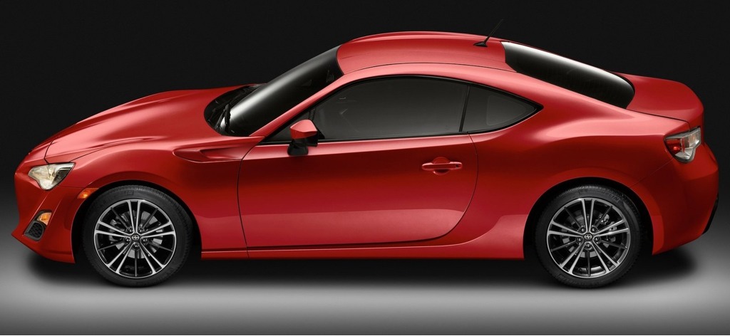

This is one of the designs we came up with. It's just a photoshop, no cad designs for it yet, but the process is started. The idea is to be functional , so this side vent would actually be a vent into the engine bay area. Obviously, that doesn't address the other concerns of such a vent, such as its effectiveness, but it would be an actual open vent nonetheless.

you can move a lot of air through 6 square inches given enough differential pressure, which is the name of the game anyway.
I'm going to order a digital manometer anyway so I may try and get some underhood and on the hood measurements as well as at the fake vent.

You could also slap on a 12v Fan for the vent to create low pressure under the hood.
