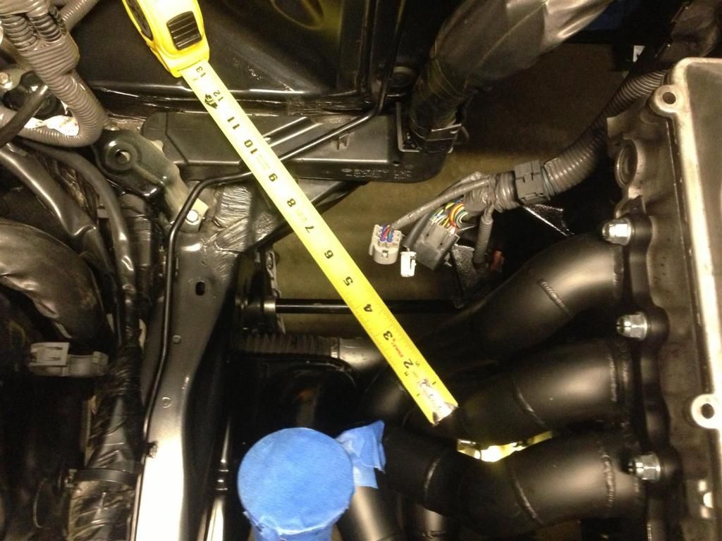

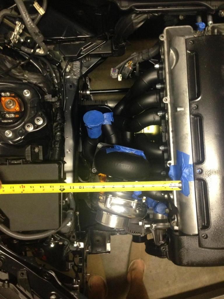

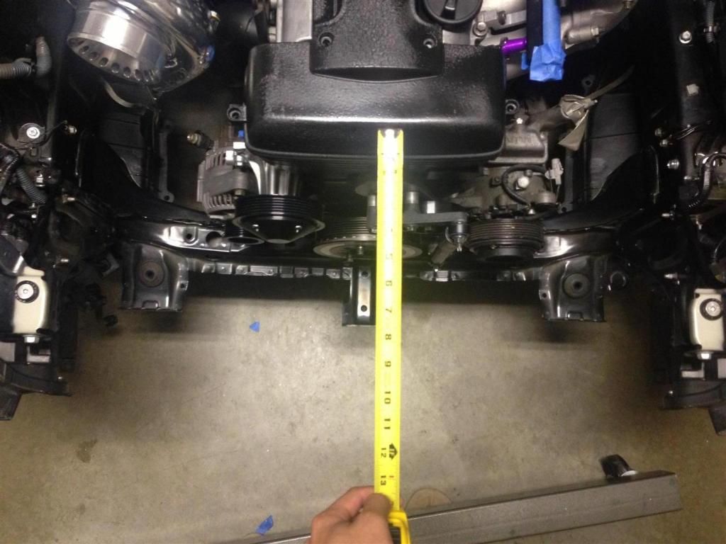

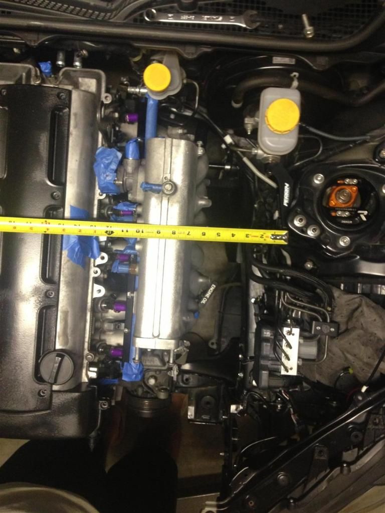

Some awareness on how much room there is in this bay.
Wastegate/exhaust, plenty
Turbo/manifold, move my fusebox and I can fit virtually any size turbo on this PHR S45 manifold.
Intake, only small issues are aft side of fuel rail. Engine will probably be moved up another half inch or so and that should account for heater hoses as well.
Forward. Sits 1.5in above current radiator mount. Might mod it for more clearance but it's good currently. The vertical brace that runs between both the radiator support on the bottom and the hood latch area needs to be cut off, braced otherwise.

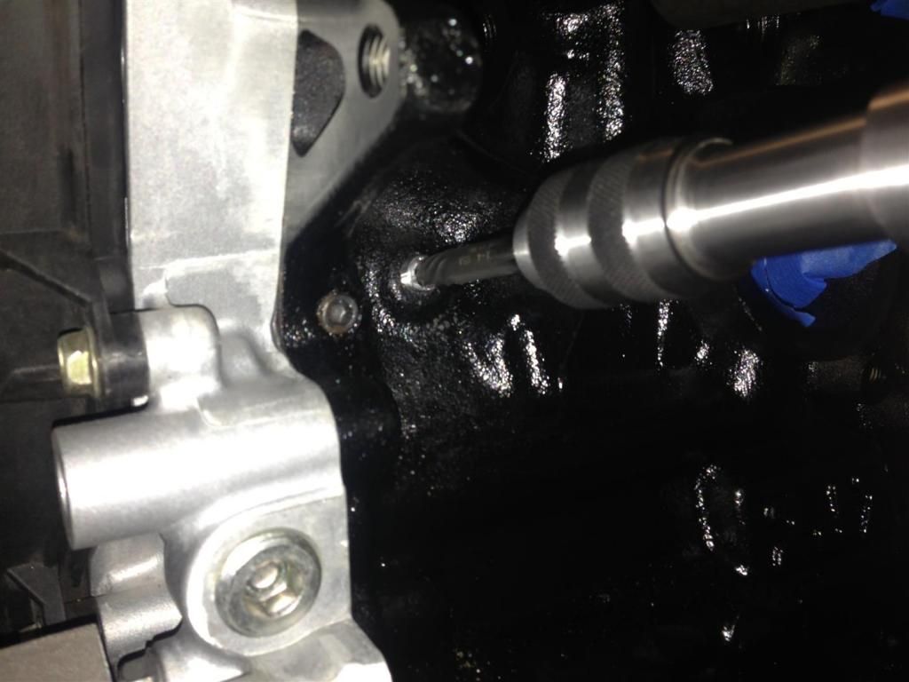

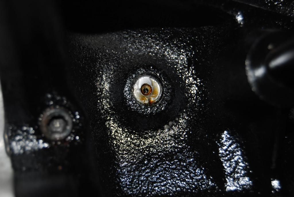

Some more parts ordered, but mainly for removing broken oil sensors. I used the incorrect torque wrench (20ft/lbs at lowest setting) to install the oil pressure sensor. Thought I'd be able to feel when it was good to go. That little bastard broke off. Ordered some screw extractors and another appropriate torque wrench for these lower torque setting items. Lesson learned, hopefully I can extract it with no issues cause I *really* don't want to pull the motor apart again. Oh well, I guess it could be worse?

Got that bitch, that could have been bad.

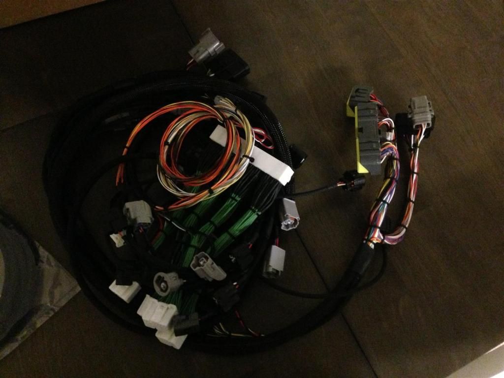

And my Chase Bays harness came in.

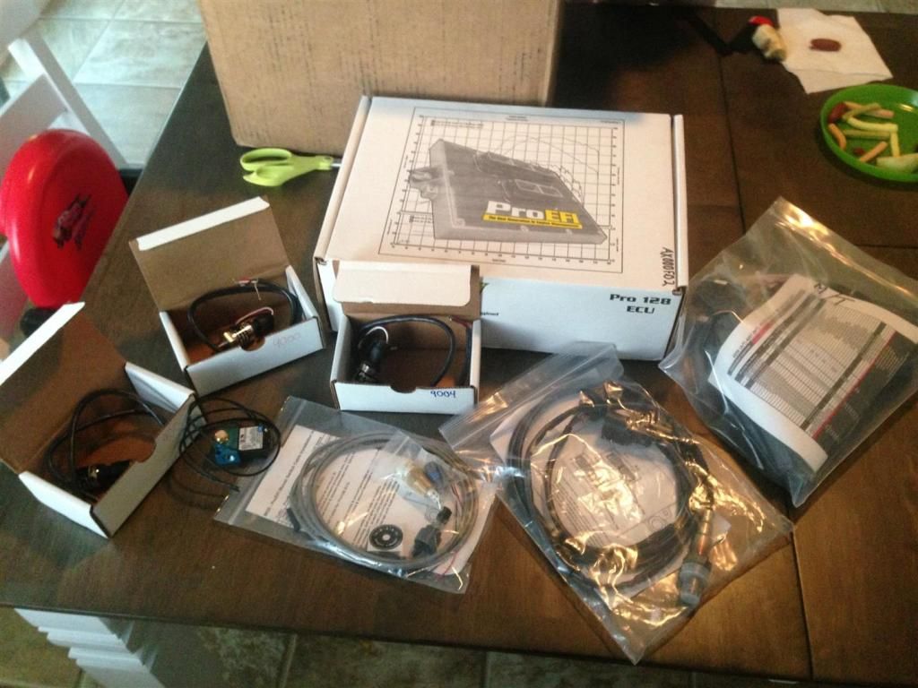

ProEFI setup came in today.
Also waiting for my ProEFI color CAN logger display, Clutchmasters FX850 twin disc clutch setup, and I also found an M85 IS300 diff for a good price in great condition. They'll all be going in the car by next week. Aiming to have first start-up before Christmas. Will be mainly waiting on driveshaft and some fab work.
Props to Induction Performance and Powerhouse Racing for all their help!
