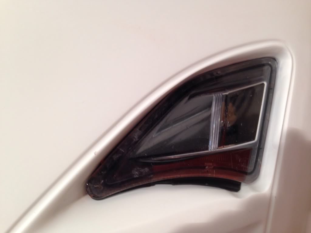

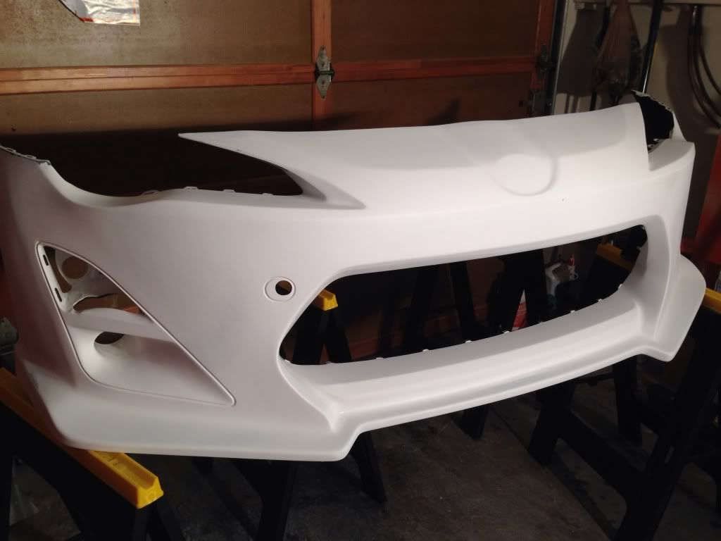

Parking lights are going to take some hours to fix for sure. Lot's of sanding to do on this as well. The area around the headlights that seat into the brackets will need to be trimmed too.

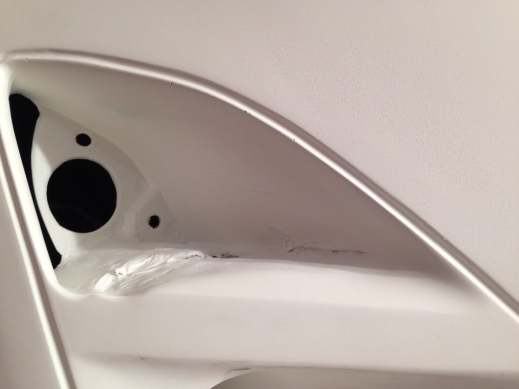

Sanded and ready to repair some holes around the parking lights. Now that the finish is smooth I can see little dimples here and there that need to be filled as well. I'm probably another 8 hours of work to paint ready at this point. Have 3 hours invested so far.
I'm not going to screw with making a spot for the side markers. Not legal but whatever, if you run smoked or clear it's not legal anyway. It'll look nice and clean without them.

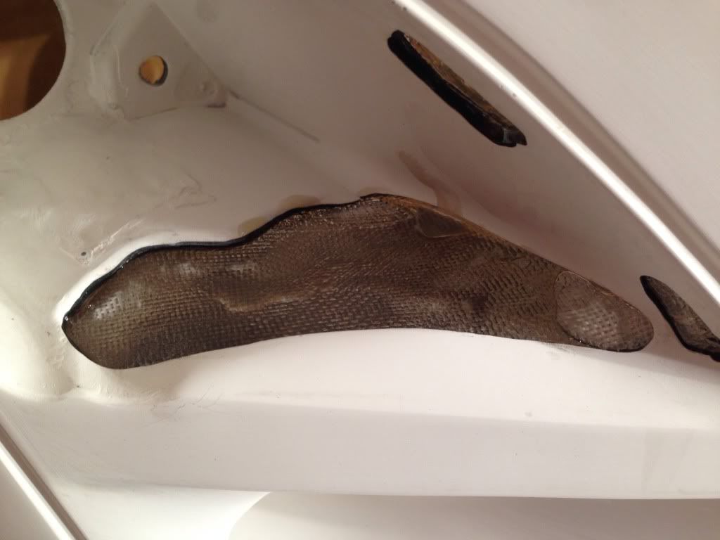

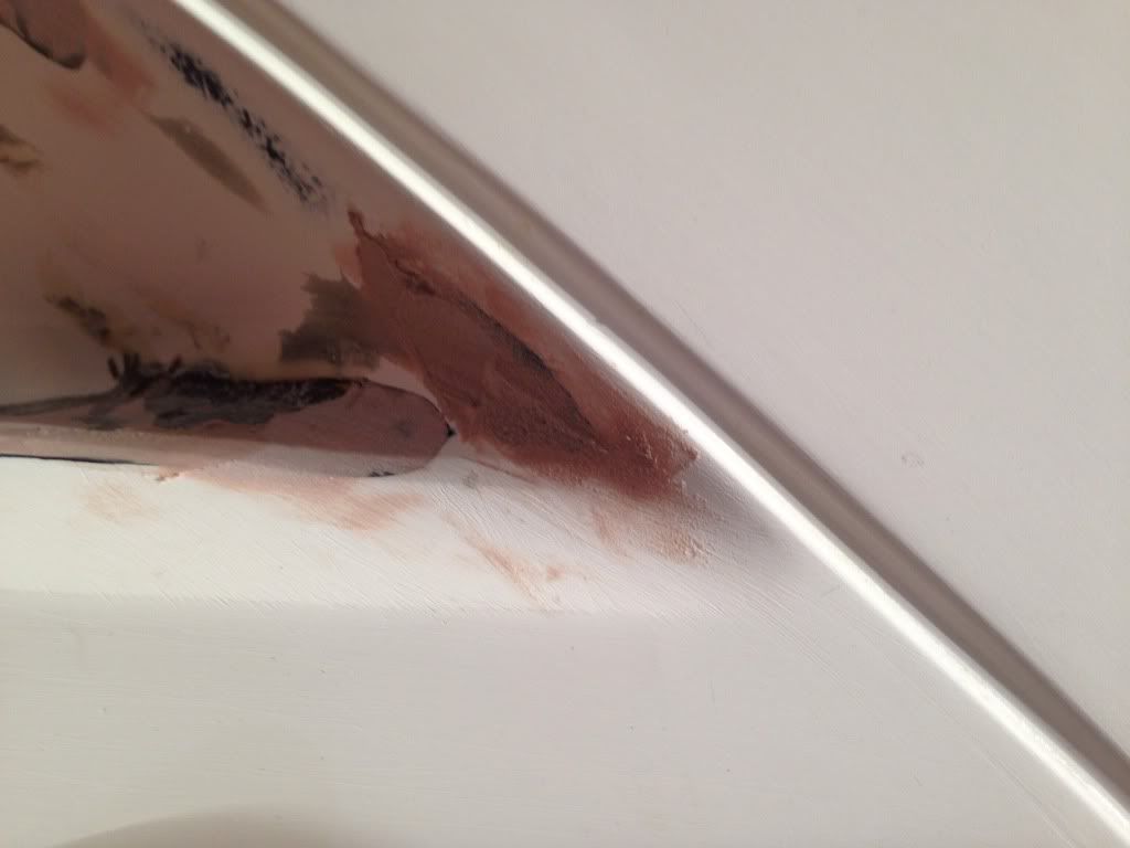

Over the last 4 nights I put roughly 2 hours in per night and have it paint ready with the holes and gaps around the parking lights fixed. I only wet sanded down to a 400 grit since it will be plastidipped. I might bond the groove around the tow hook hole tomorrow since it is so off center. Another thing I'm kicking around is just fiberglassing over the entire parking light spot and only leaving the brake ducts. The Spyder headlights could take over the parking light function if I pull the trigger on those, just don't know yet. Anyway, progress pictures.

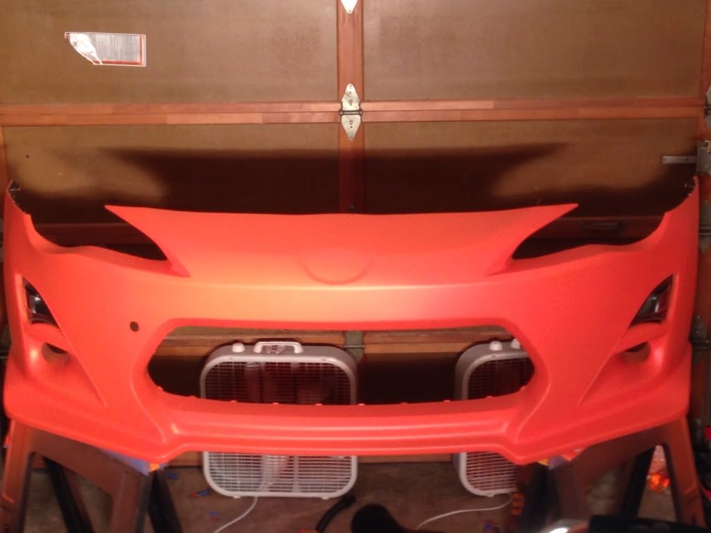

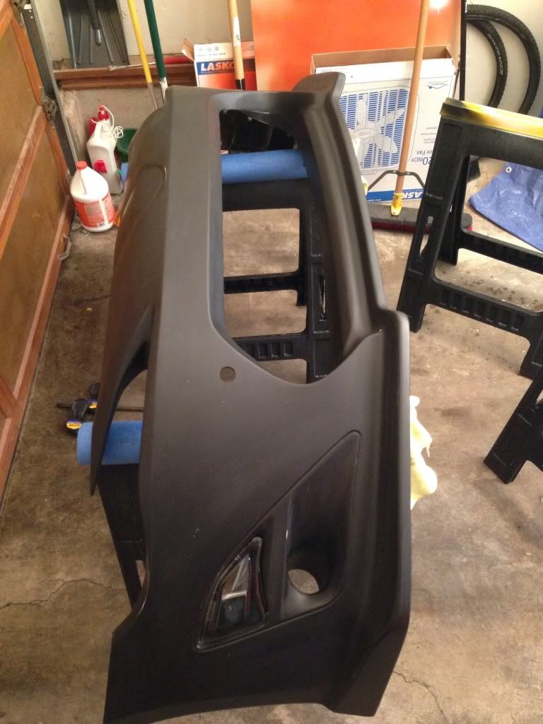

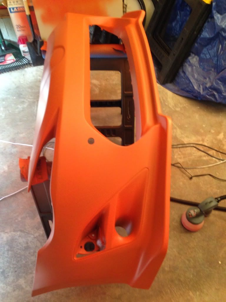

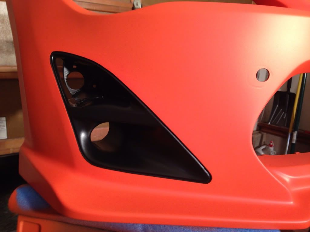

I dipped the bumper over the weekend. Looks good. Went to snap in the grille and guess what... didn't fit. More filing was needed to make it go not the tabs. I'm going to hold off on final fit up until my S/C is installed. The tabs seem brittle in spots so less on/off is better here for sure.
I sure hope this was a fluke and not indicative of all the bumpers that are shipped. It's a lot of work to get it to where I'm at now and the grille kind of pissed me off. I'm not convinced it will stay in place so we'll see how it goes. I could always epoxy the tabs to lock it in but until final fitment is done this isn't an option.
Filled in the groove around the tow hook hole since it was so off center
Primed it black so I was starting with the same base color for Plasti Dip application.
It's Koi Orange!
And tried two tone with dip for the first time. Came out great!
Here's my less than idea work space
