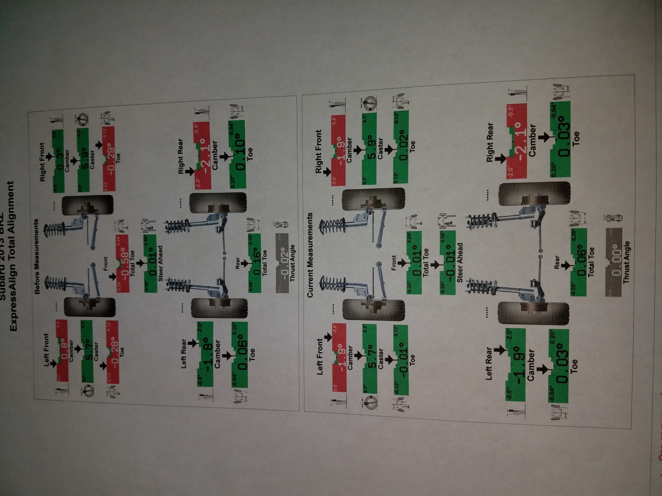

Alignment done!

Coming along nicely. You may find you want a lot more front camber.
I second this..i went from -2.2 to -3.2 up front and it feels amazing through the corners.
That's the max negative camber I could get using stock top hats, setting this car up almost exactly like the Chin BRZ that Randy Pobst raved about. I can always add more with camber plates if I need to.

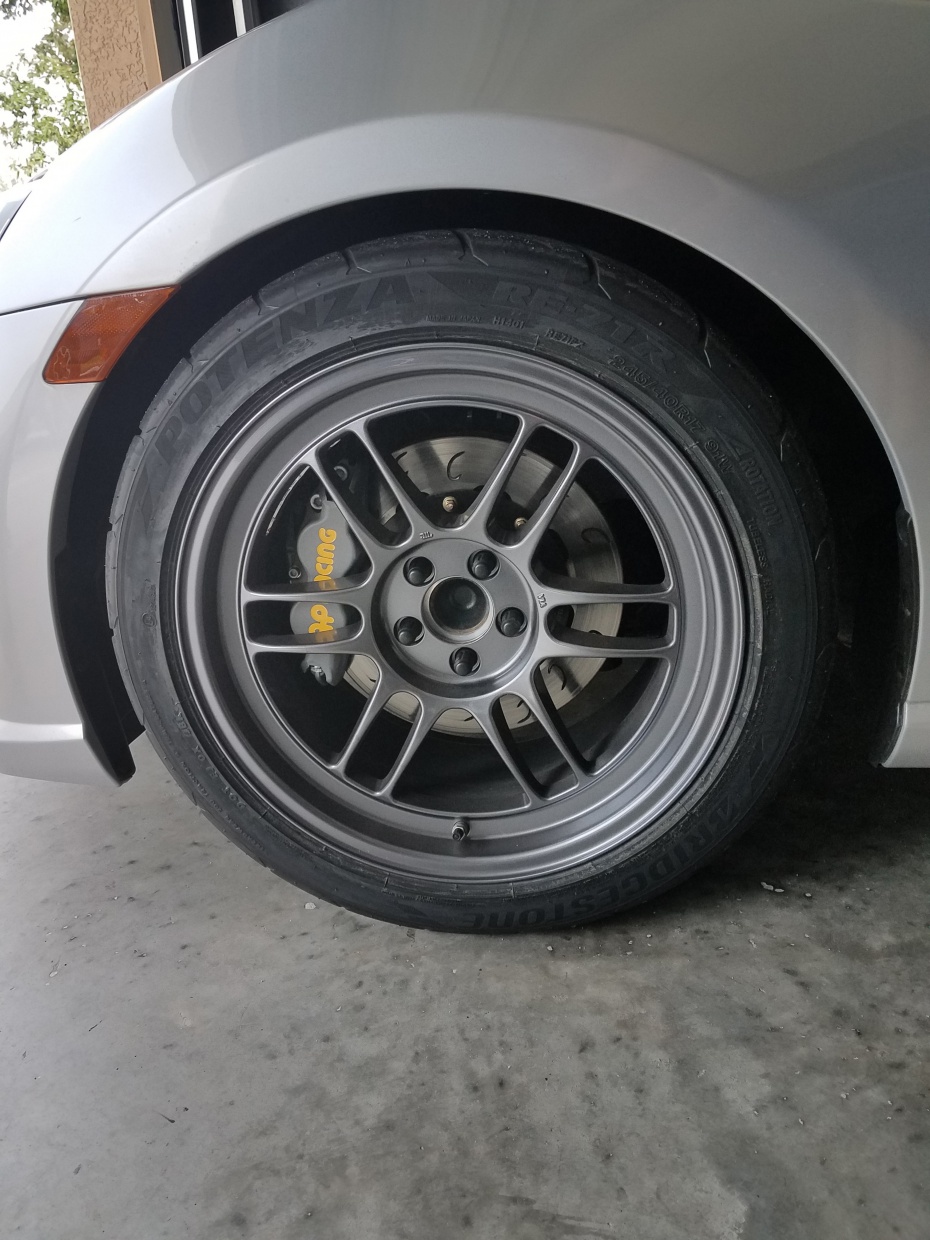

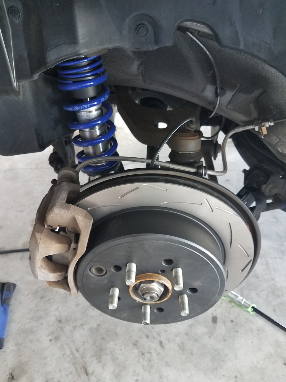

Finally got around to installing all the braking goodness I had sitting around the house today!
Rears: DBA 4000 Series Rotors, Performance Friction Pads and Spiegler Brake Lines.
Front - Essex Racing designed AP Racing Competition Sprint Brake Kit with Performance Friction Pads and Spiegler Brake Lines.
All ready for Chin Track Days at Sebring next weekend!
