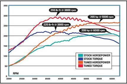

I'm sorry I wrote that wrong. The frs turbo was done by ptunning and the wrx was done by a different shop. Two different tuners lol sorry about the confusing. And yes I agree different shops and dynos show different variables. This one below is also on a wrx with e85 but it has I believe a down pipe and full exhaust and intake. And yes not showing as much torque in lower rpms but still really healthy numbers

And this one also e85 with bolt ons but with boost turned up to 22 psi on stock turbo

Originally Posted by -Willis-86touge View Post
I agree ptunning prob has the best available! Still I beg the question on what the mgt2259 would do on are motor. Fact it's smaller and twin scroll so should be more responsive and dare I say it less "lag" and I understand that the hp will not be as high as some dynos but there have got to be more than me who sees that hp is not everything. It's the ratio between hp and torque.
With, specifically, the MGT2259S, theoretically if we had piping like a DIT, I would expect full boost to be available from ~1700 RPM (catted) with ~250tq up to ~6000rpm, and ~280hp crank peak.
As with the FA20DIT, the turbo will choke the engine up top.
With some freed up flow and E85, I would expect an easy 120 crank hp gain.

The dyno only shows part of the story, there is also response. A B-W EFR turbo like the EFR6258 has much better on/off response than a run of the mill GT or IHI turbo. At the end of the day if you want more torque down low, put on a smaller turbo or use one of the TVS supercharger kits.
There is also a tuning reason why you see more gradual torque, the hard hit of torque destroys rods. There are at least a few tuners on here who tune that way.
The reason I suggested this is not to be ground breaking just to present different ideas. But using the post below you csg stated probably full boost at 1700 rpm. When was the last time you were that low in the power band when driving beside initial take off. Hence me be living that with this turbo we would never lose boost. If so very rarely! Make decent numbers. In turn creating a better daily driver.
You would absolutely lose boost, every time you lift on the throttle and/or perform an action that actuates your BOV/Recirc.
Even if you are over the minimum boost threshold RPM, you still have to wait for the system to pressurize.
If you permanently want boost, you need a supercharger, or the new NSX for "boost".
