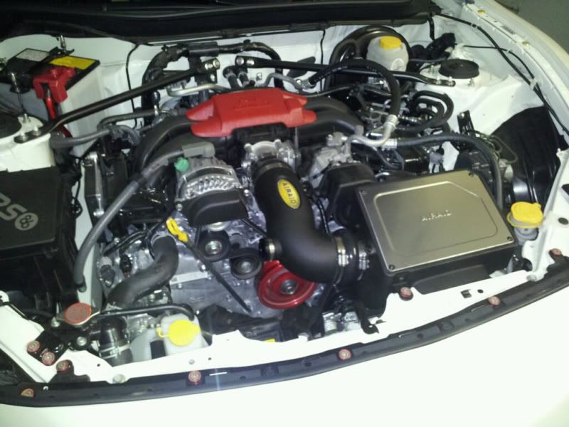

I posted up a DIY install thread and hit on removing the snorkel without taking off the entire front fender for those who are interested.
http://www.ft86club.com/forums/showthread.php?t=15376
As for the intake I only got to take it for a quick spin but loved it. Nice loud growl when you get on the throttle. The install was painless, great instructions, and the quality of the product is fantastic. Very glad I jumped in on the pre-order.

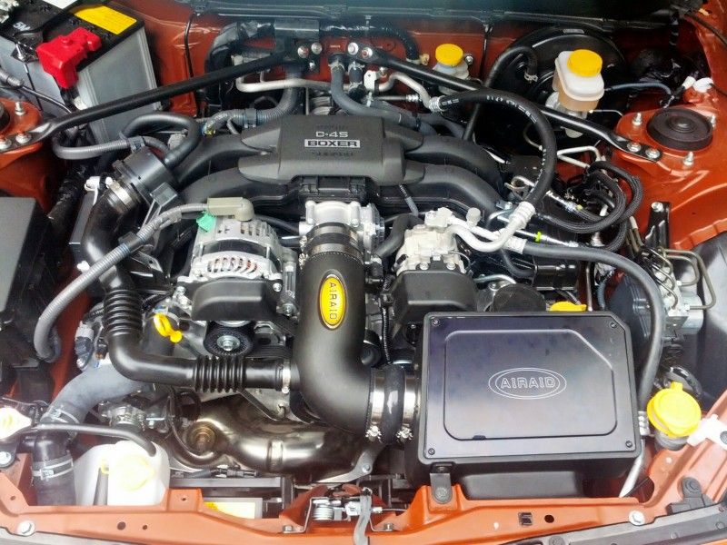

Originally Posted by lopro25 View Post
Sony, is your lid blue?
Sent using mobile Tapatalk App
No, it's just the camera flash.
