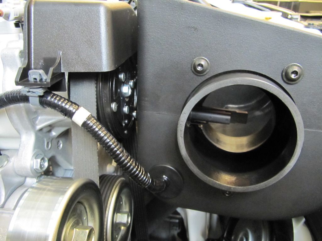

Gentlemen –
We have been made aware of an issue that *Some* Intake tubes have too small of a hole for the supplied Barb fitting. Now this is clearly not all Intake tubes, as seen by all the great feedback and installed pictures on the forum. However if you are experiencing this issue with your Intake tube, please contact us direct for the resolution @ 1-800-498-6951.
I also wanted to address the situation where the MAF wiring harness is getting very close to the fan. I will have an updated set up instructions I will post that has the fix for that as well.
Remove the tape on the clip and move the clip 1.25” toward the firewall. The tape marks the original location of the clip.
