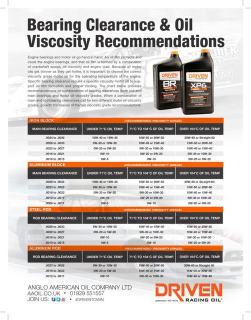

It really comes down to taking your operating temperature range, matching the viscosity of the oil at that temperature range to your clearances and material. Hence the oil viscosity temp charts in car manuals.
