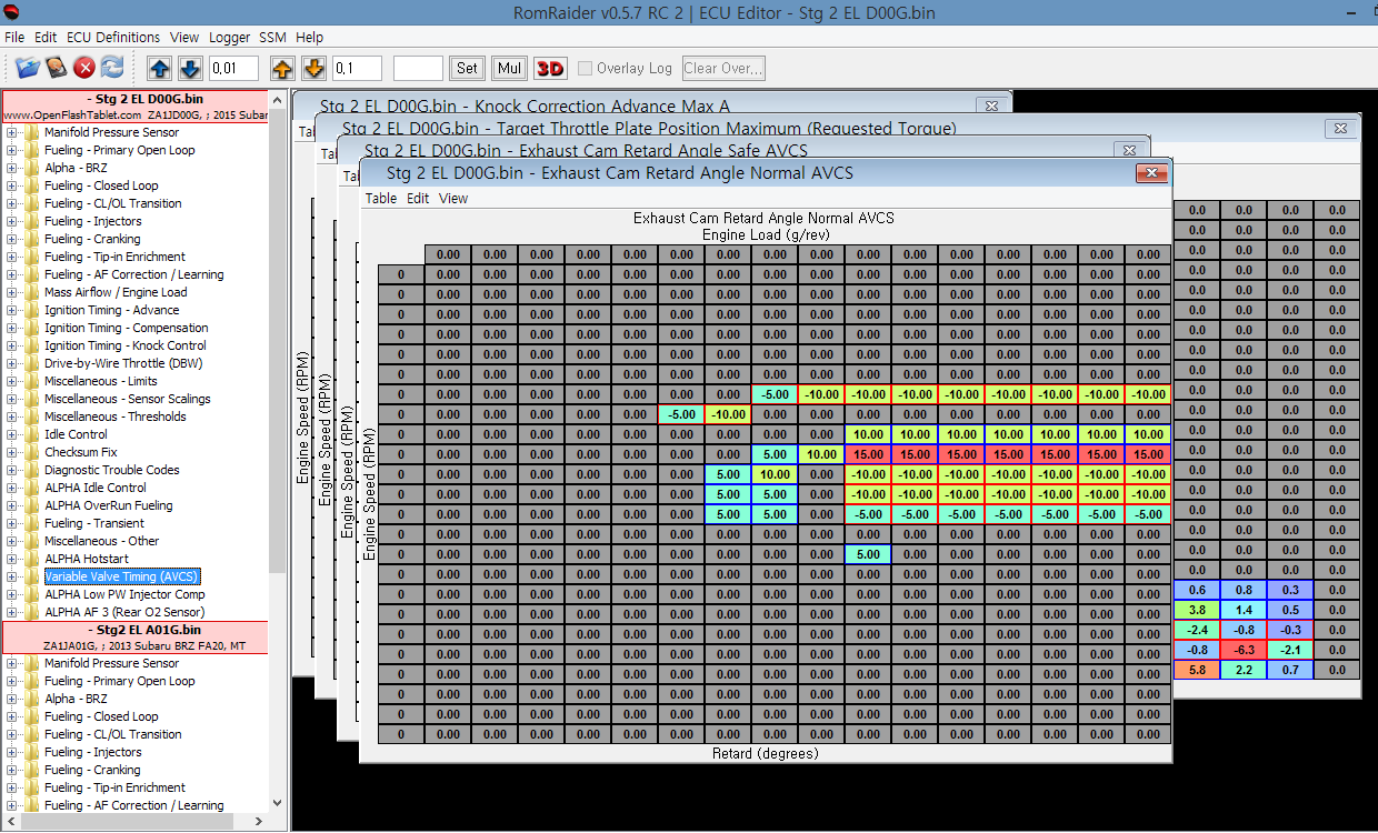

How to get the changes
This is very simple instruction to get the changes between ROMs.
1. Get the XML definitions
2. Compare the images
Now you can check which table has been changed.
3. Compare the tables
Open the changed tables of new ROM.
Compare the table against old ROM, then you'll get the cell differences.
4. Paste the tables
Open your ROM file and copy and paste changes.
You may need to get the A01X v1.5 already has the tables of A01C v1.5 to make comparison process simple. You can compare A01X v1.5 against A01C v2.0 if you know the difference between A01X v1.5 and A01C v1.5.
It is not very much difficult to make A01X images from A01C changes.
Attachment 88180
4. Paste the tables
Process is good but V1.5x to V 2xx tunes has more changes some of biggest changes were to MAF scaling and Primary OL Fuel tables. Strange they are not showing up.
Correct.
I've just done the comparison between D00G and A01G because G ROM is just released in v2.04. The screenshots will show what the process would be like, not the exact step and content.
Here is a screenshot of MAF Scaling and POL Fuel tables comparing between A01E v1.59 and A01c v2.0.
makinen is offline   Reply With Quote
