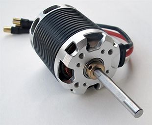

KDE Brushless Motors
I came across these and they look nearly perfect for the compressor I'm building
I went ahead and ordered this one.
http://www.kdedirect.com/KDE600XF1100.html
It's 1100kv so at a 28V Peek voltage it could run at 30K rpm. How did I not stumble across these sooner? The even have an integrated cooling fan.
