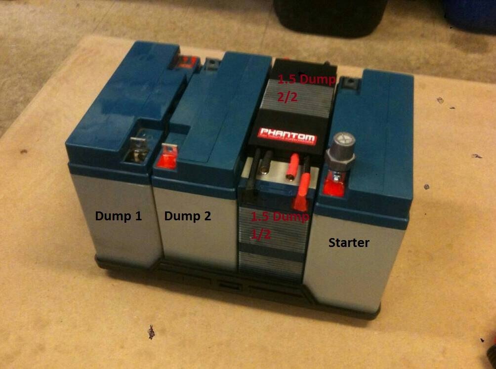

Are the batteries for the 1.5 dump pack Setup different from the original setup.
Would be awfully helpful to post links to the exact batteries and how many is required, like on the first post.
This is how the setup looks:
These are the extra two batteries you need to get in addition to the original 3. For a total of 5 batteries.
http://www.atbatt.com/power-sonic-ps...id-battery.asp
Rob is going to be updating the website soon to show all batteries required for both kits.

Battery requirements for both the standard kit and the 1.5 dump pack are now listed on Rob's website.
http://www.phantomsuperchargers.com/batteries.html

Curious what is the actual size of the 5 ½ battery setup?
And weight of it?
Will it be similar to stock size and weight?
And weight of it?
Also would the shari 5lb battery work as the starter battery?
There's a picture a few posts back that show the install in my car. It looks the same. As for the starter battery why change rob's recommended battery. It works great.
