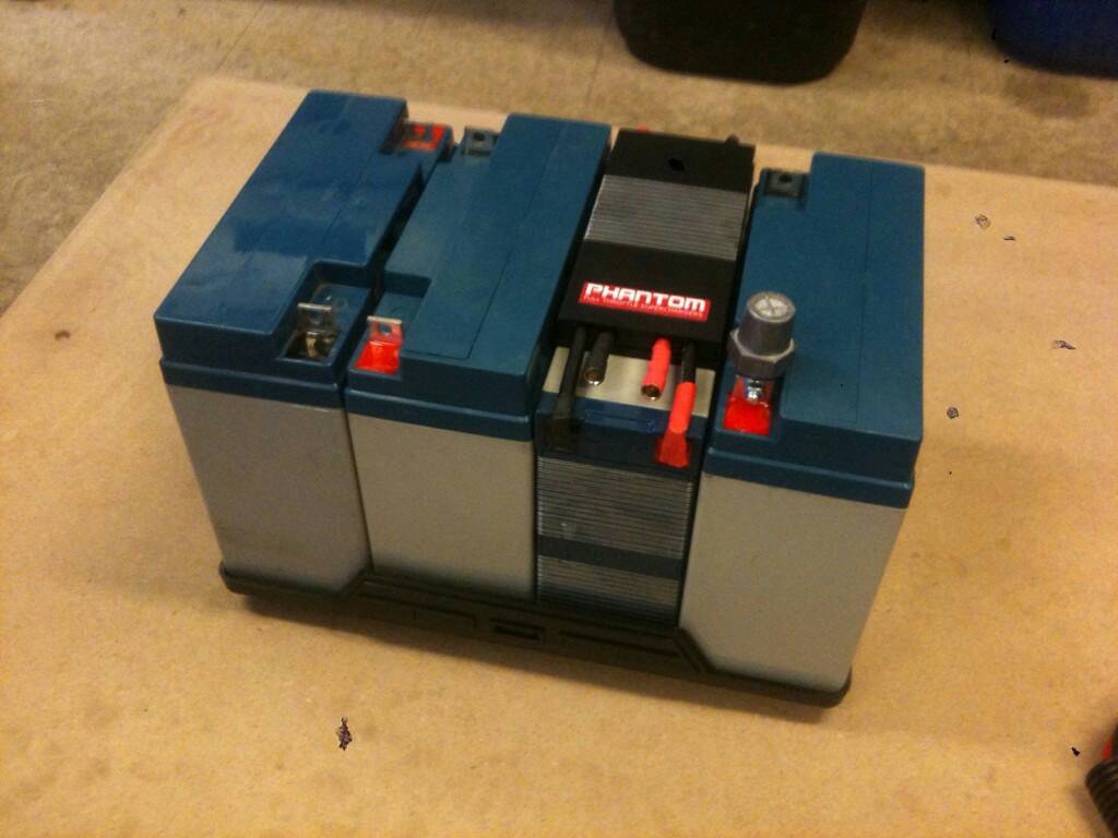

Originally Posted by robwbright View Post
Maybe I misunderstood this, too.
In the pics fenton posted, there appear to be 4 batteries on the tray. Is there a different tray to fit the 5th battery?
The 2 smaller 9 AH batteries are placed on their side with the bottom of each towards each other. By doing this the batteries are almost the same size as 1 of the regular dump pack batteries.

Originally Posted by Stormalong View Post
In the pictures posted yesterday of the 1.5 dump pack I only saw 4 batteries. Where is the 5th?
Hey guys. The picture that i posted with the phantom conversion adapter has two batteries butted up against each other.
All 5 batteries fit in the new battery tray.
Attachment 76060
fenton is offline   Reply With Quote
Attachment 76060
Yeah using this picture you can see that the two smaller batteries are on their sides. These two batteries are taped together. And the plastic piece on top puts them in series.
Attachment 76060
Underneath the Phantom sticker?
Yes see attached
Yes see attached
Attachment 76178
Sent from my HTC One using Tapatalk
Got it. Yea - I looked at the pic several times and only saw 4 batteries... LOL.
I see now that the thing with the sticker on it is actually connected to the side (actually the top) of the smaller batteries.
