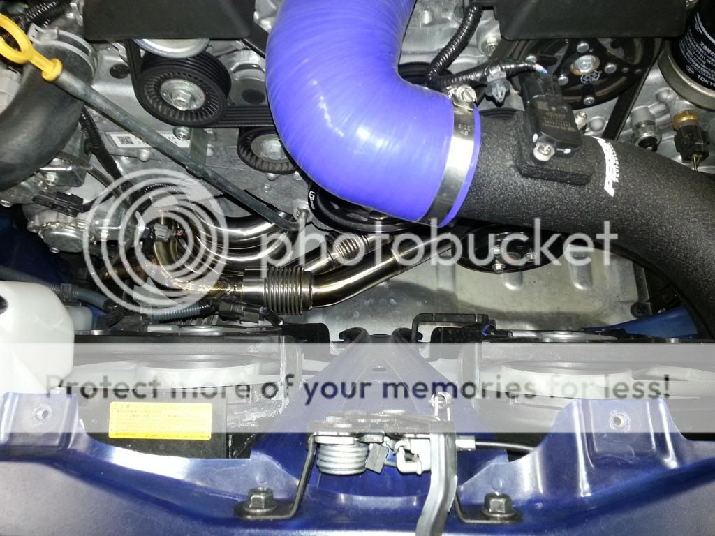

Another shot from Simmons

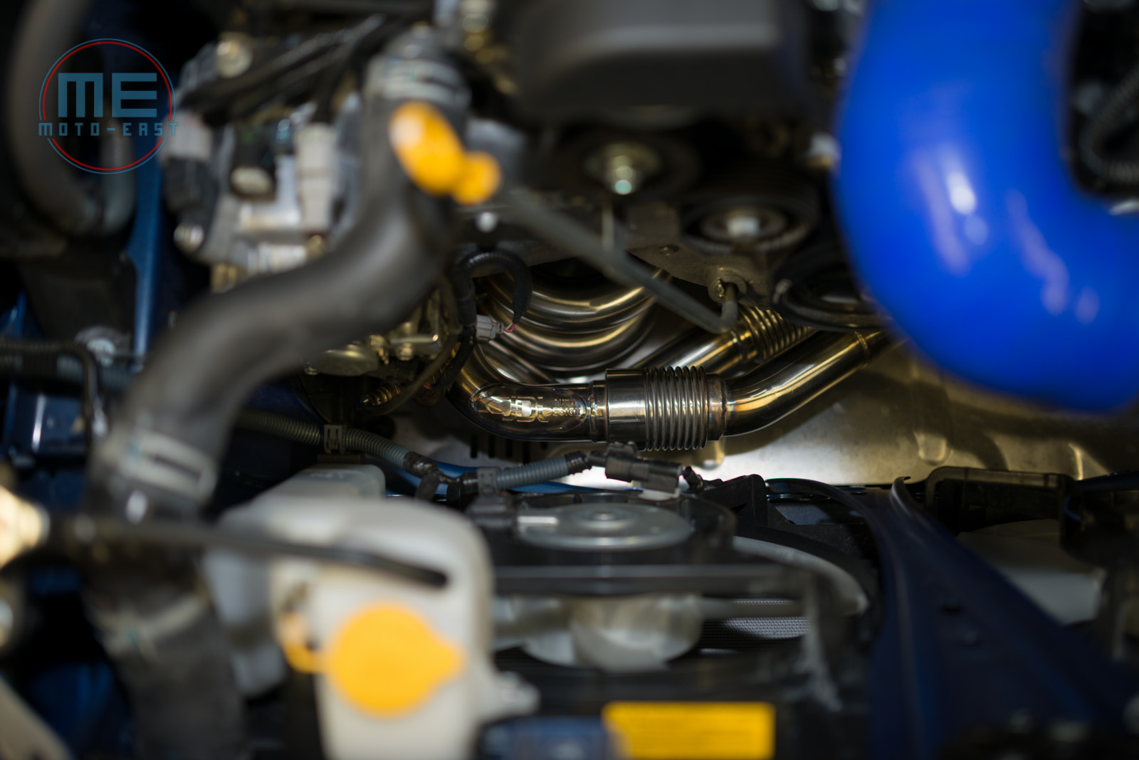

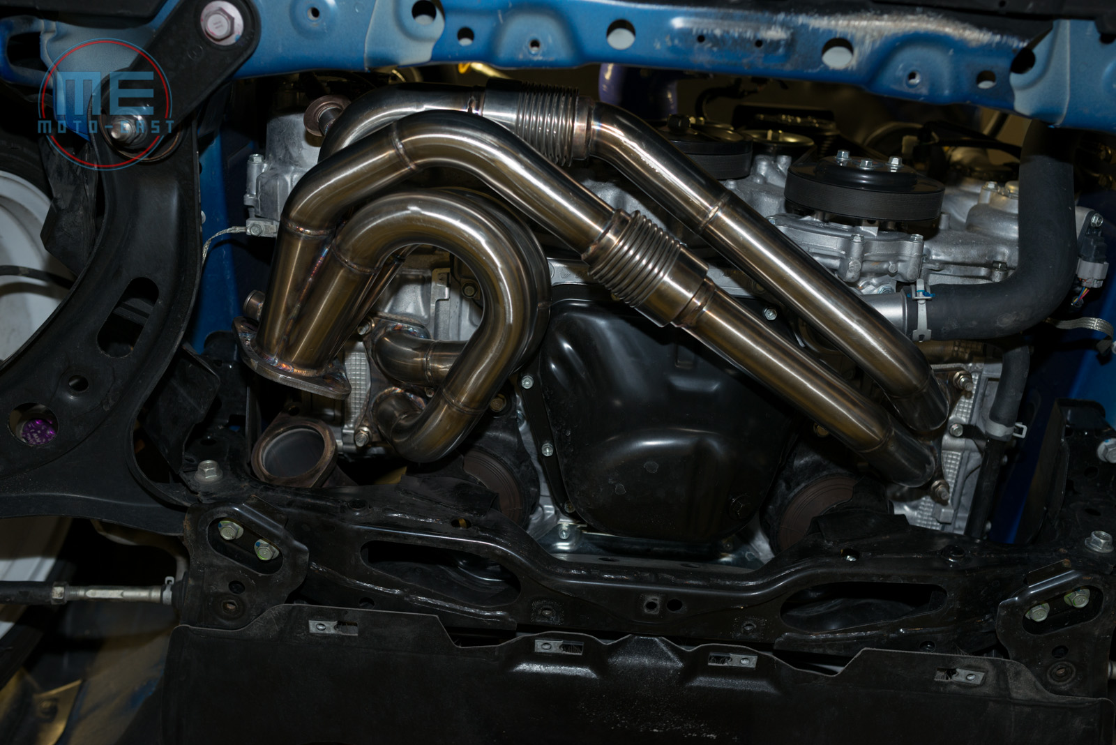

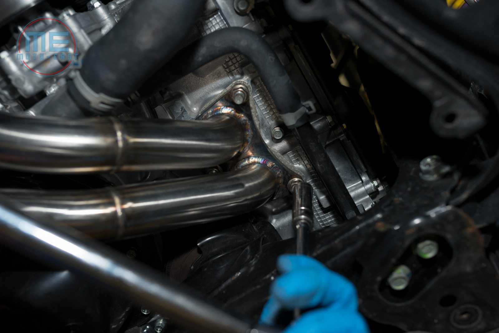

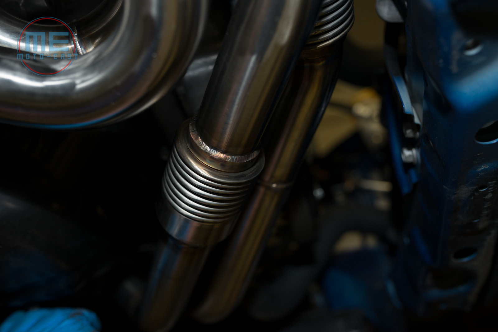

I happened to be on a return leg from a trip up north and we burned the midnight oil (literally...it was midnight by the time the second police officer....nevermind another story). Anyway we got to do some preliminary testing via g-testing and tuning. Install is super easy, o2 sensors, three bolts for each head, overpipe 4 bolts, lower heat shield...no big deal but ratcheting wrenches will make the job quicker. I can spend an hour writing but I'll let the pictures do the talking.
If you think you'll get a better one for less than 1k...you won't. Fitment was--PERFECT. As a fabricator to some degree I can tell you everything is right. The bends are as gentle as fitment allows, the runners aren't oversized for no reason, and the tubes are all round and ground smooth on the inside at the transitions. Backpurged, no overheated welds--and flex joints that work. This thing will outlast the car.
