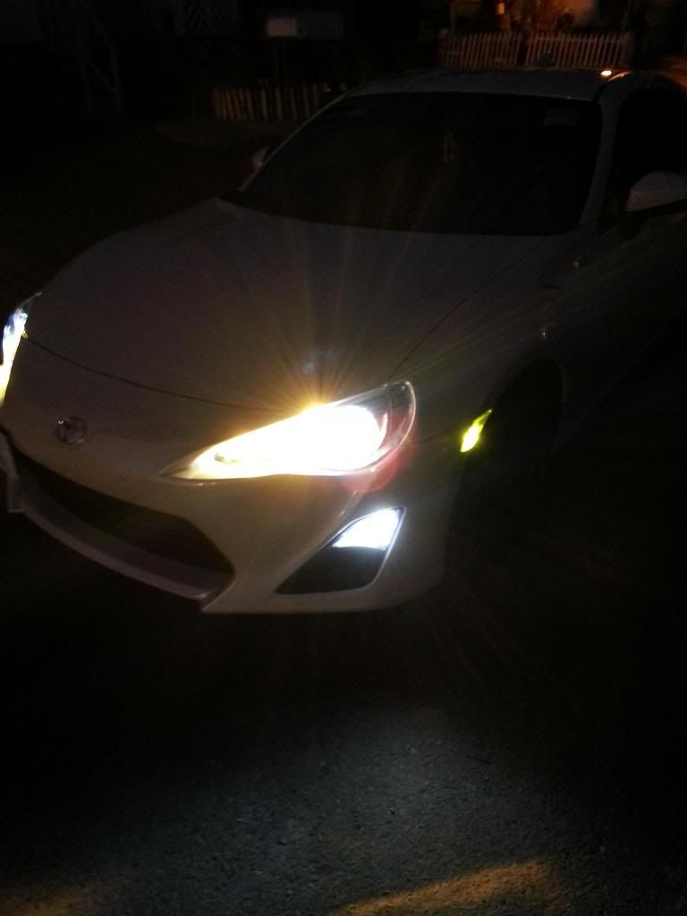

its yellow jdm style .. 2 cops passed me by and nothing
was white before too bright.. matches my dlr
