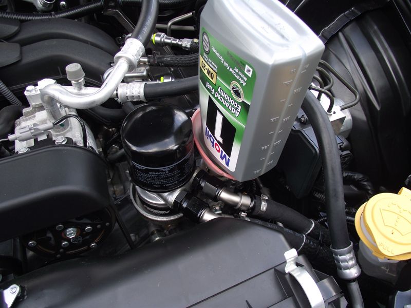

Back up top . Install your oil filter, then add the quart of oil.
Do the hoses still touch the stock air box. After installing mine I noticed the stock air box started have some burn marks. Just used some heat shield tape around the hose and the air box. I find the hose really close to the air box.
