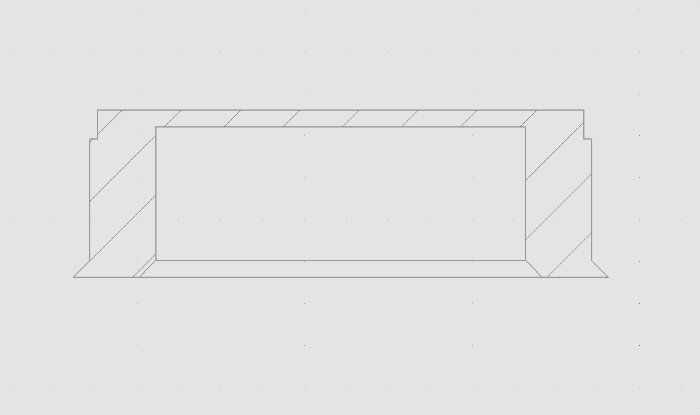

I haven't had a chance to look at the wheel that closely. Haven't test fitted the wheel to the car yet either. Does it look like a one piece hubcentric ring/center cap can be made? If so I can machine a few up if you guys are interested.
Yeah, if you take the hubcentric ring and put a flat face right on top of it, I bet you could fabricate something that sits flush with the face of the wheel.

Same here, depending on cost of course - it doesn't look like it would be too hard to fabricate though, as the hubcentric rings that came with the wheel have sufficient space between its top and the wheel's face, so if something can plug that area up so that's it's flush, it would be a perfect spot to put any desired center cap decals that one would want. It would have to be ever so slightly smaller in diameter than the ring itself though, since there's a cutout in the wheel that the ring butts up against. If you take a look at the wheel, you'll see what I'm talking about. Nothing a lathe couldn't handle.

They would definitely be a lot less then the weds caps. I'd just be looking to cover my costs. I will have something drawn up either tonight or tomorrow to see what you guys think.

I was thinking something like this:
Will mount the wheel this weekend to double check the clearance between the hub nut and the face of the wheel.

The taper on the bottom may not be worth putting on there. It is there to hold the hub centric ring from sliding in and out (or fix it to the hub). With this being a wheel specific ring it wouldn't really be necessary as it would be held from the front lip. Any thoughts on this?
The taper on the ID would still be there since it provides clearance for the radius on the hub.

I don't think it can sit flush with the wheel. Rear hub extends beyond rim face I think.

If that's the case, his design could still work if he just makes it a tad taller to clear the rear hub. Maybe a few mil taller than the face. Could put a taper on the edge to make a nice transition even.
As for the OD taper on the base of the ring, wouldn't you want to keep it there since the back of the wheel pushes against it to help keep it in place?
