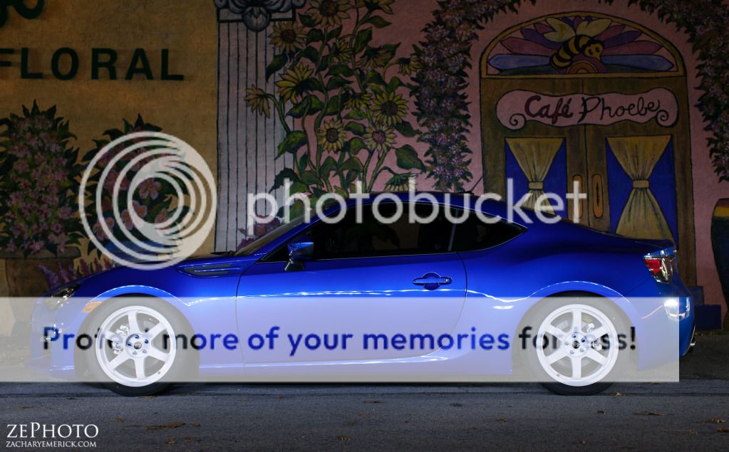

That doesn't look 3" lower?
Here is a pic of my car with the 245/40/17 at 2 1/4" lower than stock.

Yeah the tires were 245/35/17 for a rolling diameter that is 1.25" shortet than stock (and showing a bigger fender gap too)
