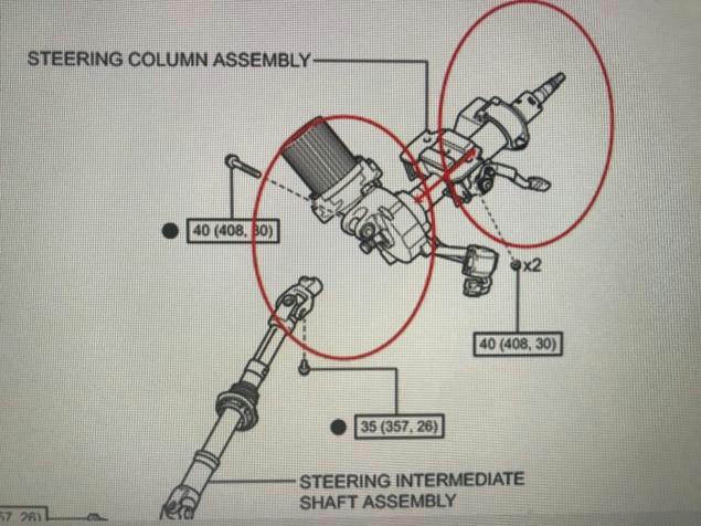

Alternative way:
Removing that forward chunk of steering column (circled by red in the blow diagram) by playing with the telescoping lever made getting to and reattaching that back bolt way easier.
MARK the connection with a marker so you can get all the splines aligned back in place.
Check diagram pic for more info.

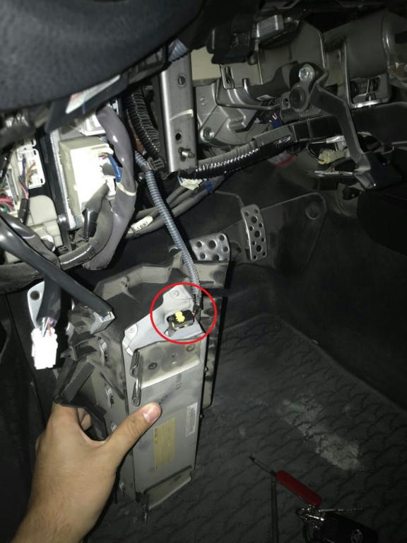

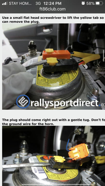

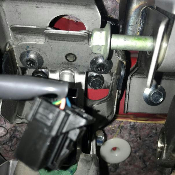

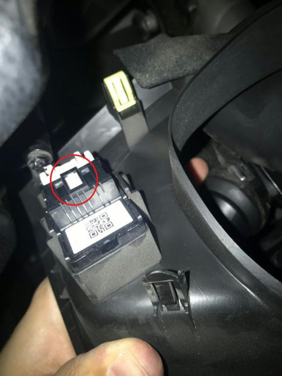

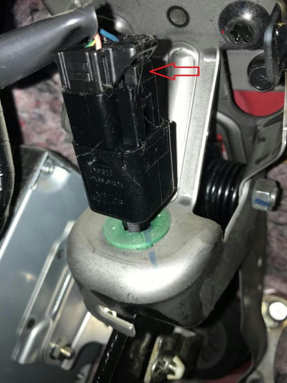

below are some of my notes while I was doing the job:
1- To remove the odometer switch, pry the circled tab at the back of the switch a flat head screw driver.
2- When removing the knee protector pad, there is an Air Bag clip connected to it. To remove the clip, follow the instructions below:
3- To remove the brake light switch connector, push on the circled tab below:
4- Below is a picture showing the notorious 14 mm bolt and why you cannot take it out without rotating the assembly:
5- I found that the 2 nuts holding the steering column were 14 mm and not 12 mm.
86Kenshin is offline   Reply With Quote

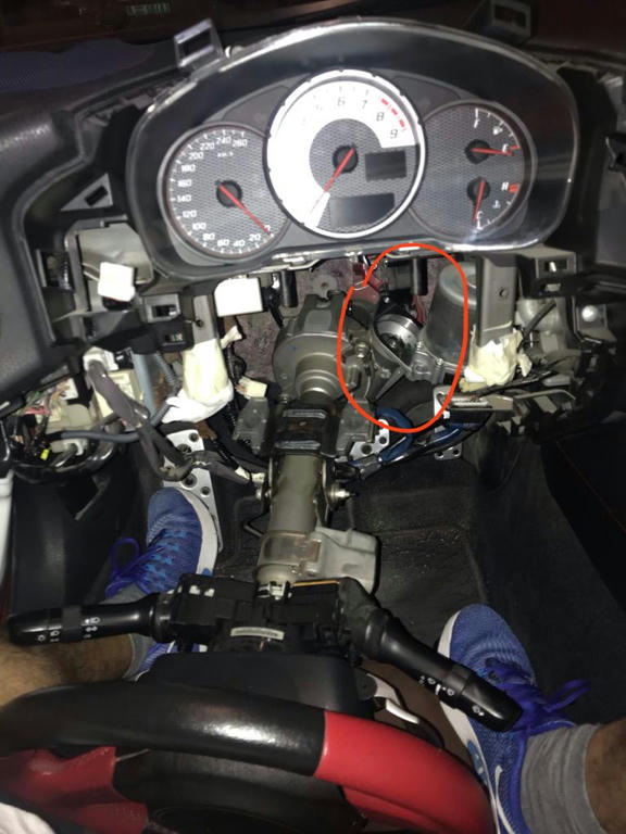

These additional pictures were very helpful thanks a lot 86Kenshin, and also a big thanks to Ermax for starting the thread. I really think Toyota needs to stock this part for this model. Heck should have been a recall for everyone that has the problem. The dealer said that they would not be able to fix this without replacing the entire EPS motor. The tech that was working on it kinda pointed me in the direction of this topic. (not here specifically)
Update: Got it working thanks again.
Just my small contribution
For a couple of steps in ermax walkthrough that helped me.
Remove column nuts
Using a 12mm socket with extension remove the two bolts which hold the column to the chassis
and
Remove EPS motor
Using a 12mm socket with extension remove the two bolts holding the motor to the EPS unit (Green Line is where the separation is) Which I used a flat head screwdriver to carefully pry open.

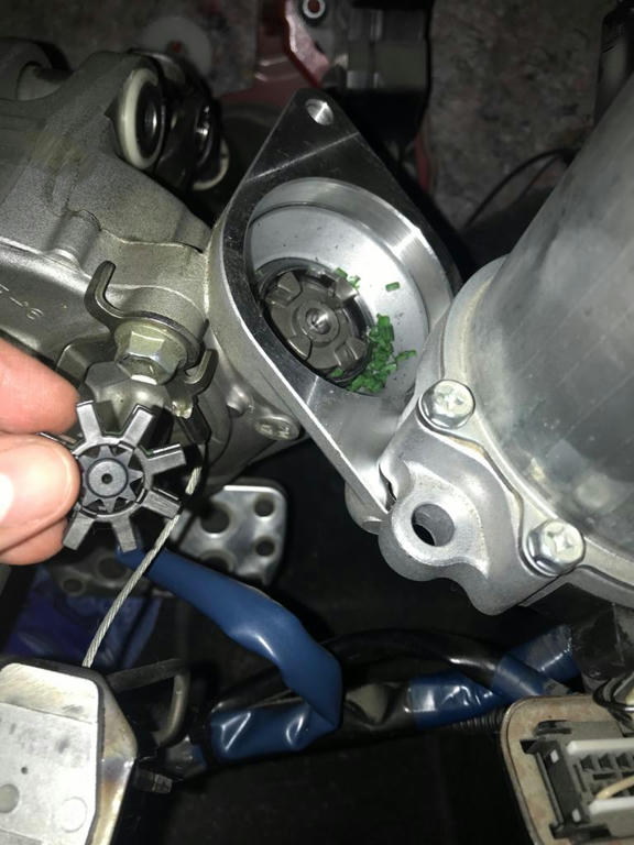

Here is a 2015 with 45k miles I pulled apart...
2020 GMC Canyon Denali Duramax, 2021 Forester Sport, 2000 Subaru Legacy B4 RSK 5MT (JDM Import) and random 86 chassis rebuilds....
