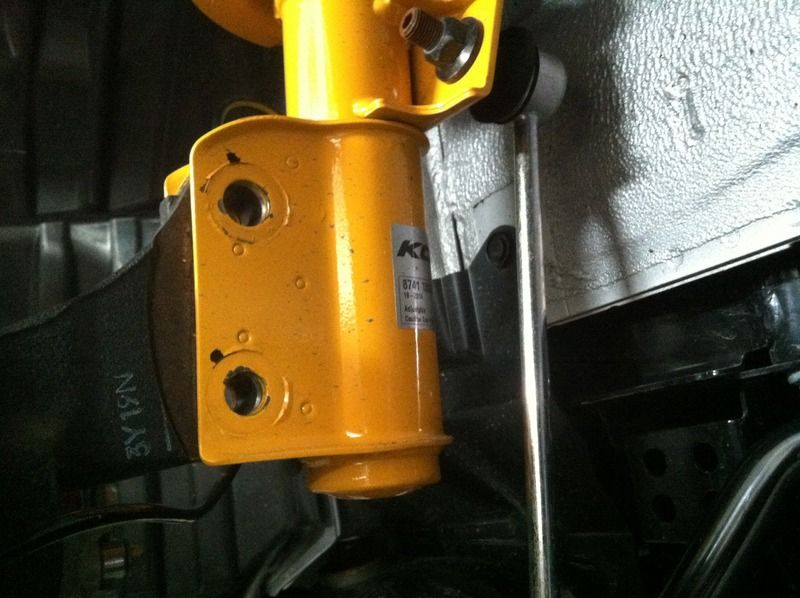

Originally Posted by ksconekiller View Post
Okay, here we go. Here's my Koni strut. Note the round (not slotted) holes.
I took the dimensions I thought were relevant to this conversation on both the OEM strut and the Koni. OEM listed first, then Koni. All measurements in millimeters taken with a digital caliper.
Bottom of spring perch to middle of top knuckle hole: 111.61/111.48
Top knuckle hole diameter: 16.28/16.32
Lower knuckle hole diameter: 13.97/14.02
Shock body to inboard edge of top hole: 20.25/20.32
Shock body to outboard edge of lower hole: 40.82/40.88
These should be the dimensions that could affect camber. As you can see, they are all ridiculously close (probably within manufacturing tolerances). I'm not an engineer, but I'd say they would qualify as being the same as far as production is concerned.
I won't be driving the car for a couple of days, so I will leave it apart in case anyone thinks of another measurement that needs to be taken.
Quoted for truth, and so that you guys understand you are arguing about tens of MICRONS.
For reference, a human hair is about 90 microns - that is larger than any of the differences listed here.
