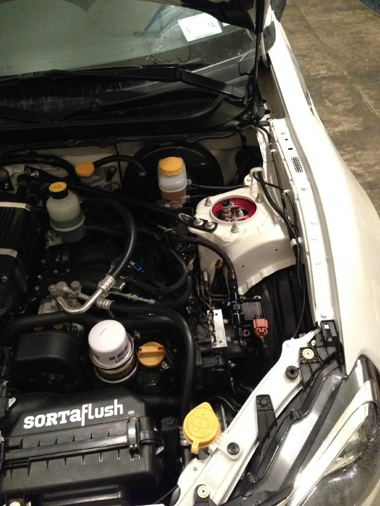

looky what I installed this weekend.
Thanks @PrimeMotoring

Awesome!
How did the installation go?

What is it?

Flex fuel

Is this your own kit?

Yes it is, made in house.
Our kits have been running in quite a few of the turbo vehicles we have built and used the faults /shortcomings of the other kits on the market to improve on our design.
Each kit contains a Continental sensor and all the lines and connections are AN fittings rather than rubber or plastic. The lines we use are E85 capable and we use fuel line clamps rather than worm clamps so it gives an even pressure around when slid over the stock fuel line. Every other connector is push to connect, no cutting needed and completely reversible.
Kit also includes a Zeitronix Ethanol Content Analyzer available in either Blue or Red display

I can vouch for them
Great quality n no plastic fittings

Flex fuel kit that detects ethanol content in gas. In the cars running it that we tuned, it detects the ethanol content of the gas and adjusts the tune accordingly. No map switching, everything is smartly detected by the sensor and adjusted by the tune.

Very easy just as I thought. Plus that ECU wire wasn't hard to get to...just like I thought
Just took a while because I am meticulous with stuff and had to make sure all the wiring was nice and neat/loomed, plus it was FREEZING in my garage so that never helps.
I wanted to do a writeup to post. Wish I would have taken a few pics, but my hands were so cold i was just trying to finish up the install. The ECA is tucked away nicely in the glove box
