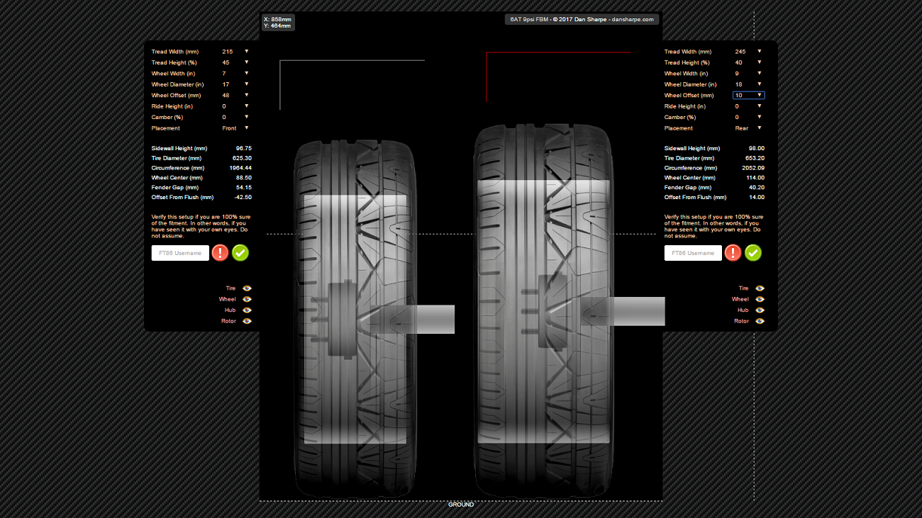

I thought offset was inverse to poke - higher number, less poke?
Either way, simulating with the auto fitment calculator I found stickied I found out that even if I'm right (+50 sinks in more) and I have a combined +10, the wheel shouldn't poke too far.
No, your right. I always flip flop the offset vs poke/suck
Forget everything i said in my first reply...
with 15mm spacer your offset is going to be +10 effectively, Still poke issues. The red line represents your fender.
