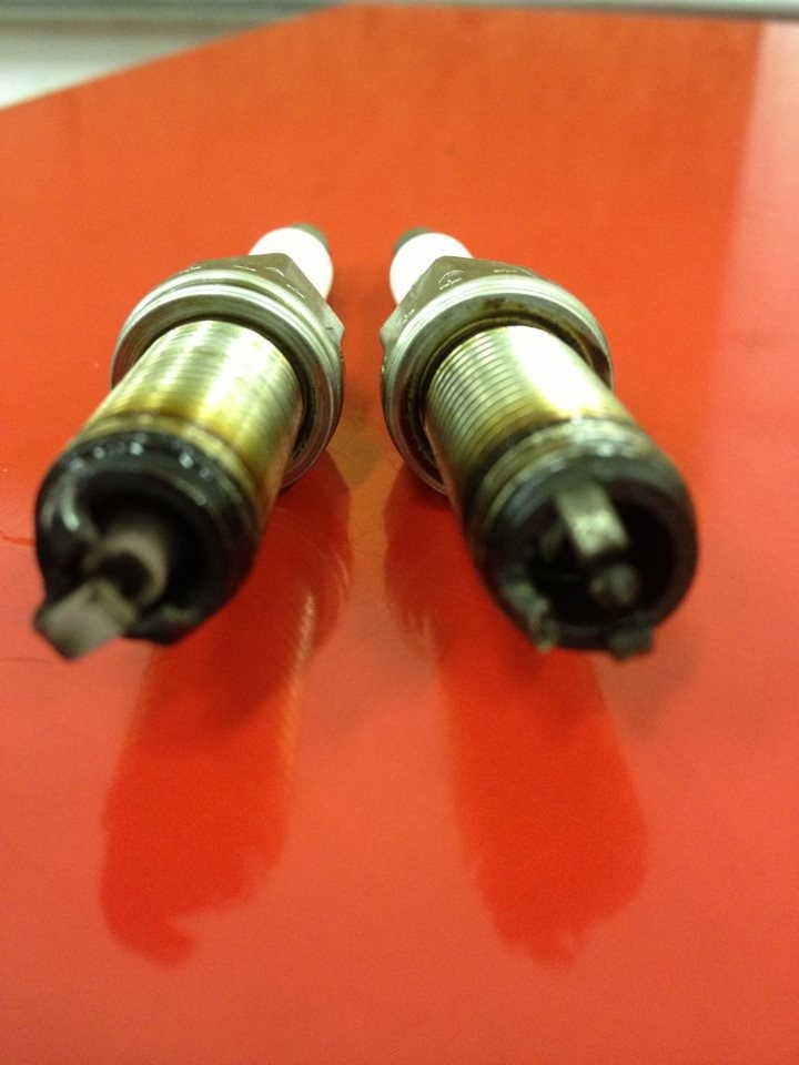

First I replaced my coils because Subaru wouldn't.
Next I replaced my DI seals because Subaru wouldn't.
Today I pulled my cylinder #1 plug and found this fouled mess.
I'll be tossing it as well.
