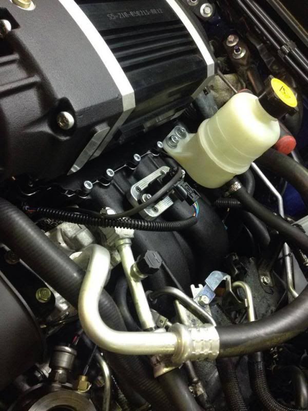

Anyone else see this on Innovate/Abby Motorsports FB page? Haven't heard much about IAT readings in a while, just figured i'd share it.
Abbey IAT(air intake temperature)upgrade on the Abbey Motorsport Sprintex Supercharger kit for the GT86/BRZ.
we move the stock air intake temperature sensor from the Mass air flow sensor on a stock car to after the Sprintex Supercharger to read charged air temperature for better calibration with the EcuTek International Ltd software.

I am pretty sure IAT's in the manifold do not read correctly. The sensor doesn't stick far enough down into the air flow. The manifold gets heat soaked and the IAT reads some of that heat.. Long story short we need a better solution. I saw a log somewhere of a WOT run with a post charger IAT.. I think the temps continued to decrease for the first 5 seconds into the run... then kept increasing after the run was over.. temps should fluctuate with boost.. not lag behind it.. reason to believe it was reading the temp of the manifold more than the air..
I thought I read something like this, but couldn't recall. Good post.
