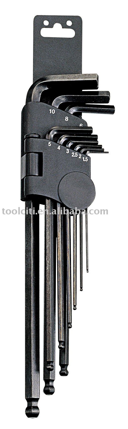

Originally Posted by xjohnx View Post
seems like most people suggest just putting some teflon tape on the threads.
How do you get those rear elbow bolts off, I'm going to get a different set of allen keys but mine via a socket and extension had no chance.
allen keys. the long handled ones with a wobble head and the regular length ones with the wobble head.
like these:

although we took the elbow off when the blower was already off the car. we reinstalled it after we remounted the blower.
