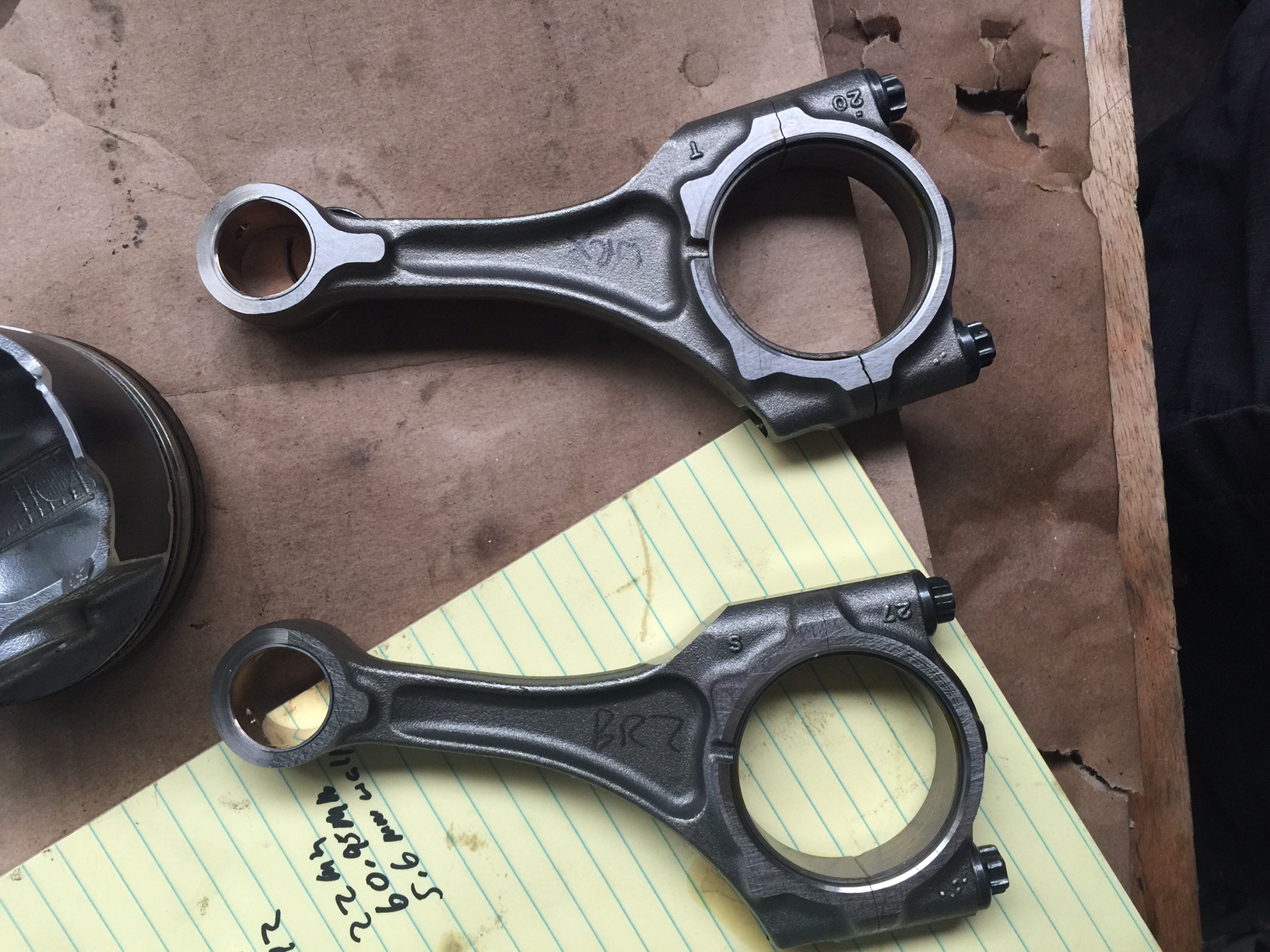

[QUOTE=moto-mike;2545126]This is what the rods look like:
QUOTE]THIS IS A PRIME EXAMPLE IF I'M SEEING CORRECTLY!!!! Look at the small end of the DIT rod that bushing looks hammered!!!!!! Mike will you please give us your input on this.
EDIT: Actually after zooming in too 200% they both look hammered on the top of the small end...
