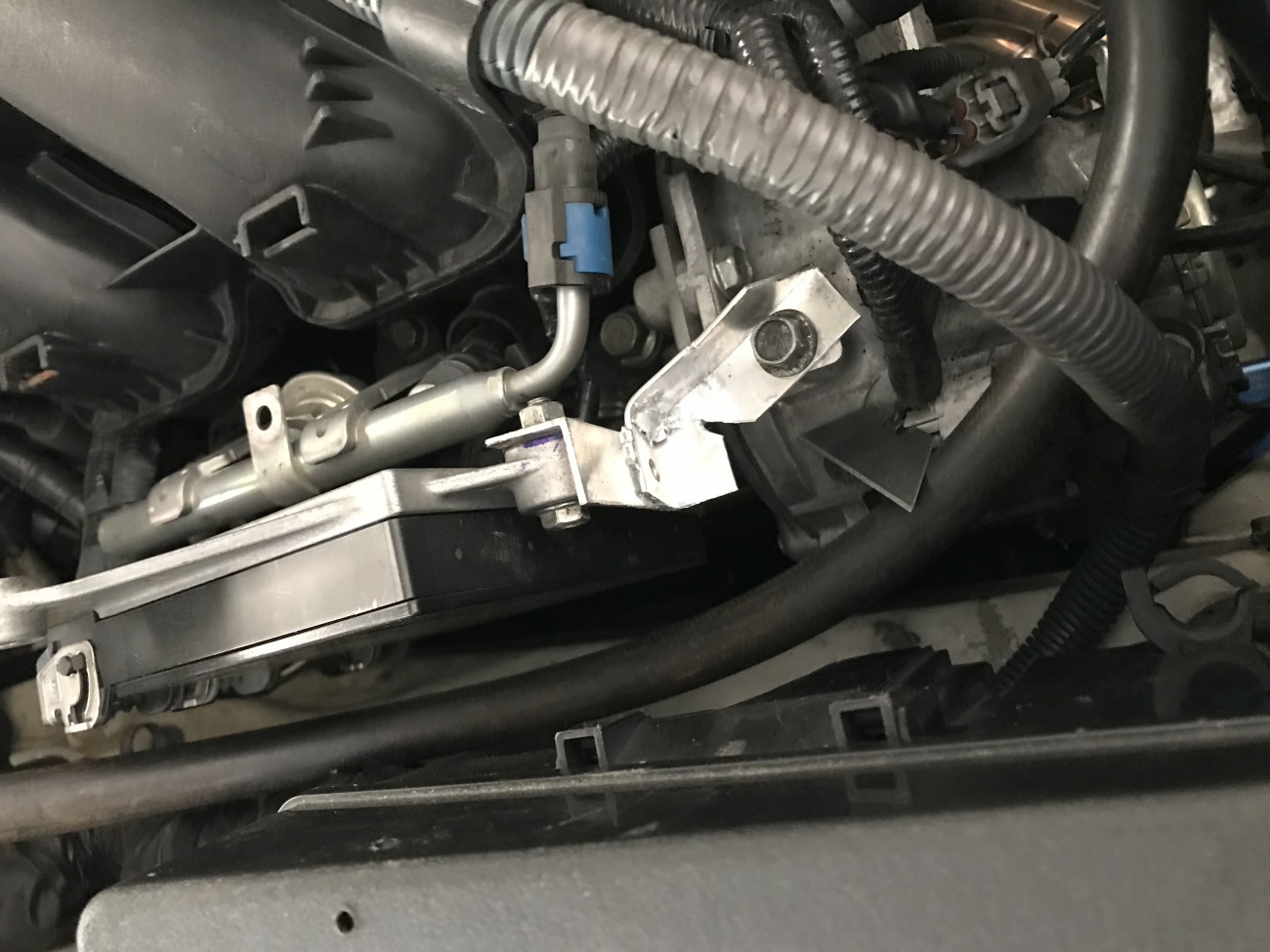

Learn how to braze aluminum and you can make some strong brackets.

Already have my aluminum bracket capped off with a lightweight titanium bolt Since the 17+ have a mounting point on the bottom of the computer I left the 3rd mounting point open but its very sturdy
