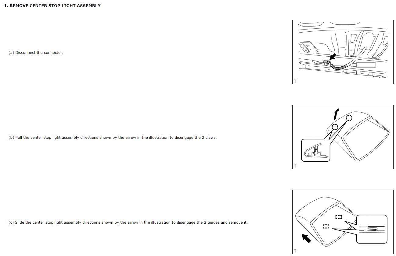

Can you easily remove the Intec brake light to clean the glass under it? That's what's annoying me with stock light...
You can pop out the top housing (part against the glass) quite quickly. Just undo the connector from the trunk and get in the back seat and pull up on the housing. Slides right back in like a charm too... just did it this weekend to clean my rear glass.
