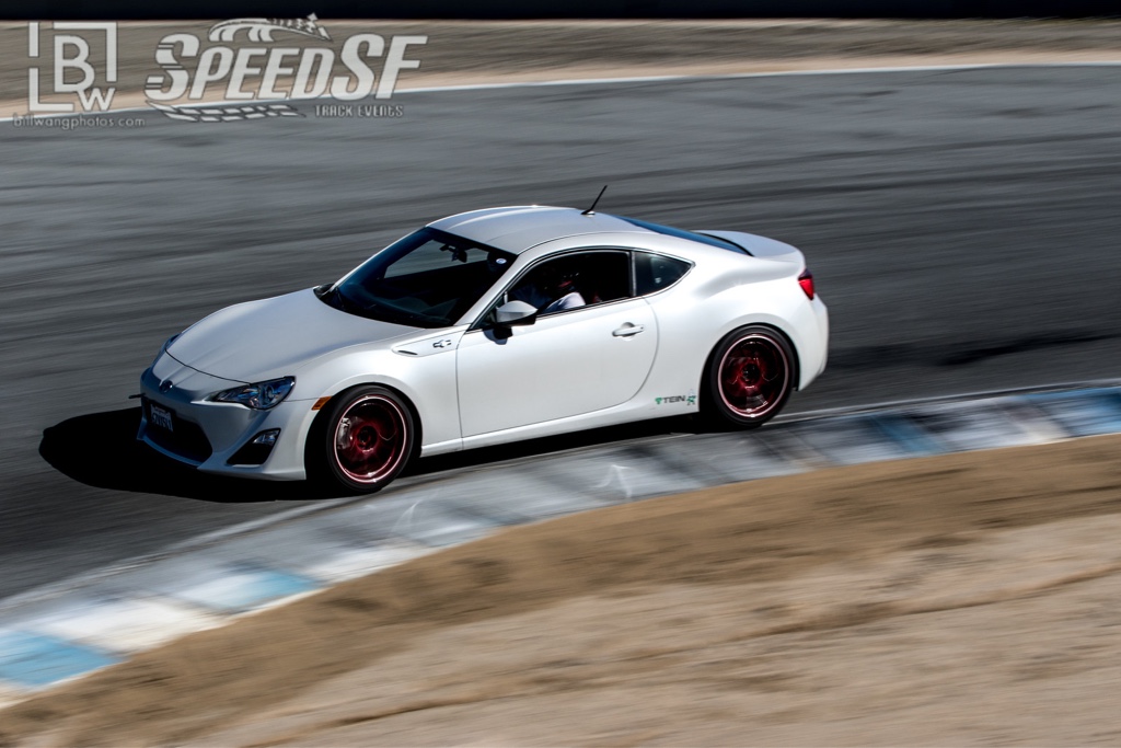

Originally Posted by xero404 View Post
Ran 255/35/18 on 18x9.5 +40 no issues even on track (see pic). 235/45/18 is a bit too tall and i'm hitting the Fender liner in the front at full lock inwards and have a bit of rub in the rear and might roll fenders. Attachment 102332
You think 245/40 18 would make the cut?

Its def shorter and I'd probably try that size next time. Heres a pic of the 235/45 Name:  ImageUploadedByTapatalk1423721207.018105.jpg
