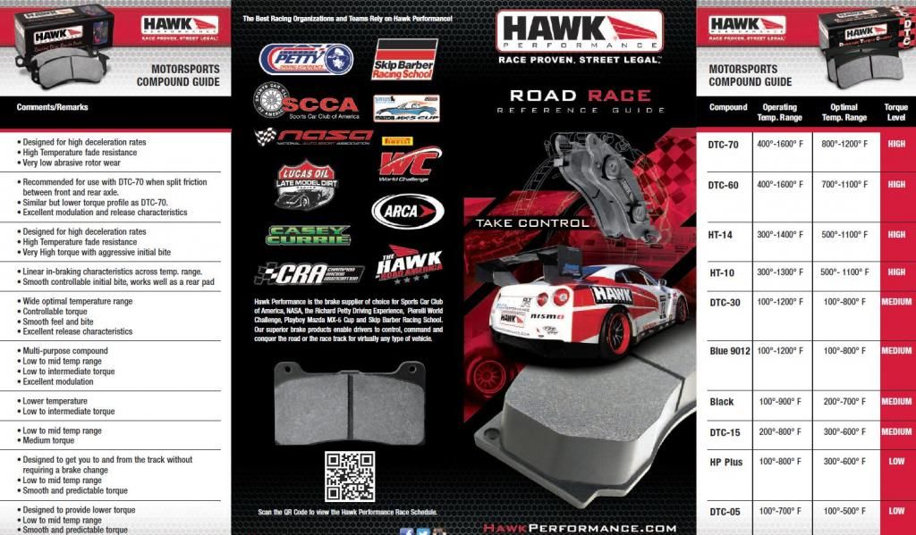

For reference:
dradernh is offline   Reply With Quote

Originally Posted by KKaWing View Post
The first post has temperature in Celsius, the later reply #16 doesn't mention scale...
250 degrees Celsius = 482 degrees Fahrenheit
800 degrees Celsius = 1472 degrees Fahrenheit
/shrug
True. I'm not sure which he was using in that post.
1,400F is enough for most drivers probably. @CSG Mike and I have both melted some 1,400 pads.. at least I'm pretty sure Mike started to, I have for sure. I'm running sintered pads now for the most part. I have some Project Mu 999's from @CounterSpace Garage as well that have been solid.
