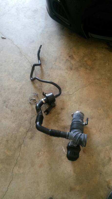

Installed a @Supertek Industries intake pipe

Where does the included plug go in the sound tube removal? Mine came in today but it's raining so I won't be able to put on until tomorrow unless I clean a spot in the garage,lol
That sucks it's raining buddy. First follow the sound tube to the connection at the firewall under the hood and pull till it pops out. Don't worry, it won't hurt anything. Then, pull the carpet down on the passenger side floorboard. It will reveal where the sound tube enters the inside of the car. Put the plug on your fingertip and push it into the hole until stays. Took me a try or two to get it to stay.

@ANTLAY also be sure to remove all the sound tubing for the clean look. Just 2 bolts (I replaced them afterwards) and 2 zip ties (I just pulled till they broke)

Dude!! Thank you !! And to clarify the cap do you mean push it until pops/swedges in?
