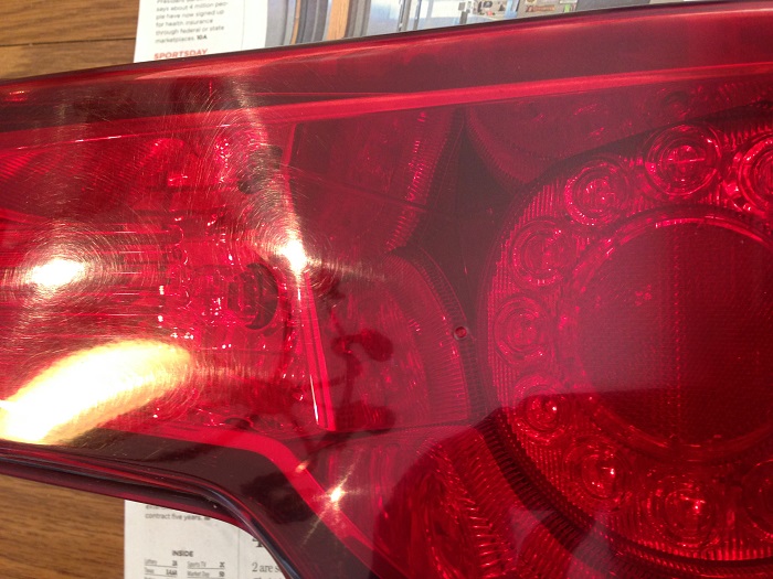

So I started and after sanding and the first coat I have a lot of fine scratches. Is this something that will dissapear with more coats or will it still be seen after everything is done?
Attachment 69422
yes, it will disappear with further coats.
and when you do the final clear coat polish, you will end up with the same type of light scratches-- use polishing compound to remove those, and then follow up with the wax/sealer of your choice.
