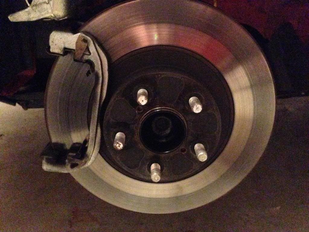

Just got a chance to take off the left-front wheel to inspect the pads/rotor since that one was squeeling constantly. Here's what it looks like:
Looking at the last picture of the pads you can definitely see that the pad closest to the camera has a dark line through the lower 1/3rd of the pad that is shiny. I'm assuming that's glazed.
As far as the rotors go i can't tell to be honest if they're glazed or not. Debating if i should get some garnet paper and try hitting the pads a bit or what i should do at this point. Only one HPDE on the pads/rotors and everything was bedded properly - the brakes felt awesome at the track. Now, definitely less bite and very loud.

Originally Posted by CSG Mike View Post
They shouldn't be making noise when you're just rolling, unless you didn't do any cooldown after bedding and you left some deposits (melted some pad, and it solidified on the rotor). Deposits will go away over time.
Took off the rotors and had them turned to just take off the top layer. Cleaned up everything possible in the brakes. Took a little garnet paper to the pads to make sure they were clean.
Re-bedded the rotors/pads and the squeel is back. Keep in mind i didn't use the shims or any grease. Time to put the Bobcat's on and save the XP10's for the track.
