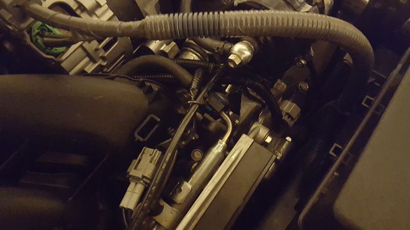

Need some advice here: I'm installing the DW700cc injectors along with my DT flex fuel kit. I upgraded to the fuel injector adapters that connect between the DW injectors and OEM connectors. But now I can't fit the drivers side metal cover over the injectors because the adapters are in the way. Is it okay to leave the the metal cover off? Should I trim the metal cover (which would be a bitch I imagine)? Or have I angled the injectors incorrectly. I feel like I tried every combo. The passenger side metal cover was a tight fit but I managed.
Never mind. I ended up sucking it up and just notching the metal covering on one spot for the passenger side and two areas on the driver's side for fuel injector adapter clearance. I probably went through 4 dremel attachments. It was a bitch but it's done. If the metal covering exerts any pressure on the adapter/fuel injector combo, you get a spray of fuel all over the place. Don't ask how I know!
Any pics on what you were looking at?

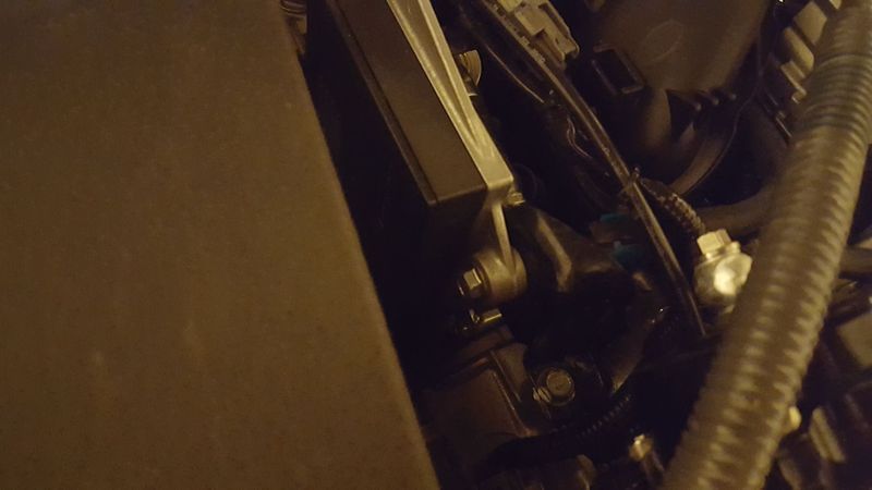

Sent from my SM-N920P using Tapatalk
Sorry! I just looked and I don't think can take any good photos showing the notches I made. On the passenger side metal covers, the DI ECU is blocking view of the notches I made. I'll post a picture of the driver's side which shows the one notch I made but it's not a very good picture. Basically the the DW injector/adapter combo sticks out too far. Simply cut into the metal covers so that the injector/adapters clear. Once you have injectors installed on the fuel rail, it will be very obvious where the metal covers are fouling the injectors.
I asked this on the DT flex fuel thread but thought I would put the question here as well:
I left both of my covers off. I then cut the passenger side cover that also holds onto the ECU to not cover the injectors and still hold onto the ECU. I'll post a picture for you in 5mins.

The factory covers would rub and hit like mad. This was 1 of the many cutting completed to get my turbo kit to install. I don't want to talk about how much I had to cut into the factory HID headlights to get the pipe from the inter-cooler to intake to fit.
If that cover is applying ANY pressure your better off cutting it entirely vs causing it to rub and short while driving it. The last thing you need is the damn wires to shorting out when driving. No one likes tow trucks.
