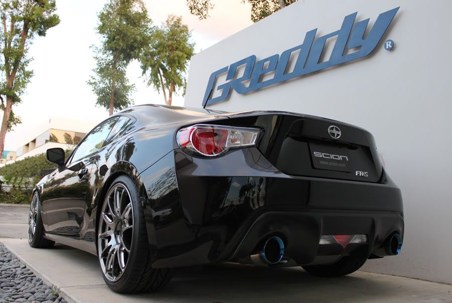

Originally Posted by RRnold View Post
Seeing the GReddy FRS w/9.5's in the rear makes it seem almost impossible to go another 1" wider.
I won't say it can't be done but at the same time I don't want to mention anything that starts with the letters H and F! That might strike a couple of nerves here!
F* it, I'll say it. HELLAFLUSH haha.
Looking at the GReddy FRS, I noticed a few things. One, being that it was running 19s. Second, the tires were the "proper size" for the wheels, thus, no stretching. Also, from every angle I saw, it looked as though it was running the factory camber settings. Going down to 17/18s, stretching the tires, and adding camber.....10.5s would be possible. HOWEVER, I think 10.5s on this car is overkill as well and in order to make 10.5s fit, it'll require some work which, in the end, will make the car just suck.
I'm all about and down with hellaflush cars-but I hate the people that do it with wheels that are too big, tires that are about to pop off the bead, and wheels cambered in 4+ degrees front and rear just to barely fit. I wanna be flush, but still wanna enjoy my car haha.

That tyre is bordering on too narrow for the wheel.
Why did they use a +35 wheel on the rear? Was it to appeal to the HF kiddies, or was it to clear a coilover spring?
Say you went to 18s with a +45 offset, the proper tyre for an 18x9.5 is a 265 or 275/35. The 265 would be positioned almost exactly the same as the picture above in relation to the guard (fender) and a 275 would sit about 5mm further out.
So not only is a 10.5" wide tyre possible, it looks pretty easy and could be done without making the car look like it belongs in a cartoon.
Of course with anything less than 300hp, it's also pointless.
I would agree that a 10.5 would be pointless other than for looks but i think the 18X9.5 +45 would be best both look and functionality wise. Oh and the 265 has a minor stretch so depending on your style you could go either way.
