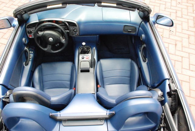

Originally Posted by Stephen02 View Post
This is more subtle but it reminds me a lot of the colored interiors that Honda did with the S2k.
Attachment 214797
I miss interiors like this; much more interesting than black, charcoal and gray.
This is my ST162 Celica
Anyway and back on topic - changing out that insert looks really good. Nice work!
