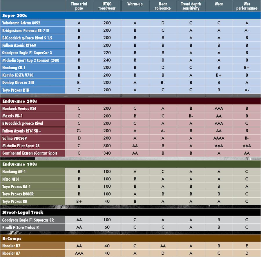

Good info from Grassroots Motorsports
https://grassrootsmotorsports.com/ar...Ui_BtNtQH2xbrg

based on this chart the 660's look to be best all-around 200TW tire that can kinda do it all. Solid crossed the board but nothing outstanding.

Going by this chart alone the Kumho, BFGoodrich, Michelin, and Goodyear are better with no tradeoffs within that super 200 category.
