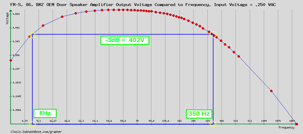

I decided to set up my test station and go ahead with my plan to plot out the frequency vs. output voltage readings of the door speaker amplifier today.

and through the headphone jack, I ran the left and right channels combined for a mono signal into both left and right signal inputs to the amp, with one volt meter reading the input voltage on both positive and both negative wires simultaneously.
Then ran several individual test tones from 5Hz all the way up to 2200Hz while keeping the signal input voltage steady at .250 VAC and monitoring the output voltage at the left negative and right positive speaker output wires with my other volt meter, and without any speakers connected.
Then proceeded to record each voltage output reading at each test tone frequency.
Here is the graph I plotted out,
Name:  FR-S, 86, BRZ OEM Door Speaker Amplifier Output Voltage Compared to Frequency, Input Voltage .25.png
It was just like I figured initially, a low pass crossover with a subsonic filter.

@FR-S2GT86 Just doing some quick calculations it looks like the amp has a usable bandwidth from about 8 to 350 Hz as it is currently being filtered. The op-amps and power output chip appear to be good for the entire audio spectrum.

However, not particularly a big issue anymore since we have the frequency characteristics of the amp output now, which was what I was wanting to know all along.
It would have been nice to simply use an oscilloscope or RTA and a pink-noise generator to test this amp's output characteristics, but I don't have one available, and Poppa needs to pay off his new head unit, so I won't be purchasing one any time soon. Priorities I suppose. It would also have been nice to have an amp dyno to measure the output with both channels loaded with 2 ohms each. Maybe that can be a project for someone else at some point.

Well, I certainly appreciate your effort. And you did confirm something useful about the frequency response of the amp for those who want to utilize it with an aftermarket head unit or speakers. Given the skill level required to work with surface mount devices, rather than trying to modify the amp to broaden it's usable frequency response it would probably be better to just plan on replacing it.

Agreed. There are many choices of inexpensive aftermarket class-D amps that can be chosen to replace this OEM amp that would give you gain control, adjustable filtering, etc. But at least I learned something on this project.
It gives me more knowledge on why Mr. @Tcoat is unsatisfied with his factory system, and is giving me an opportunity to help him and others to increase the quality of sound coming from their "new and improved" factory systems by making a few tweaks of the wiring.
