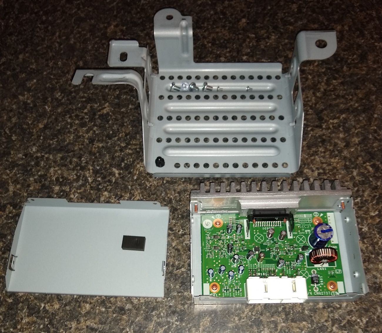

Here are a few pictures from different views with the bracket removed:
Attachment 201144
Attachment 201145
Attachment 201146
Here it is with the top panel removed:
Attachment 201147
And a closer view of that:
Attachment 201148
And with the circuit board removed from the housing and flipped over:
Attachment 201149
There are no switches and no adjustment potentiometers on the circuit board at all. It is matched to the factory head units that utilize it. If you find that your amplifier is not plugged in and has a bypass plug installed in the signal input/speaker output connector instead, then your OEM head unit does not provide a 12-volt signal to turn this amplifier on and it is powering your door speakers directly along with the dash mids and tweeters.

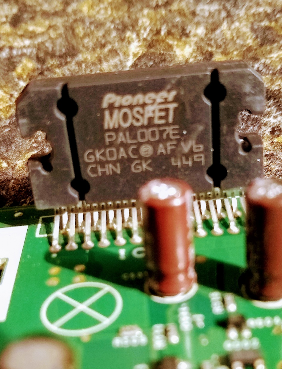

@FR-S2GT86 - Any possibility of getting a number for the main power amp chip, IC301, the one attached to the heat sink?
FYI - Regarding the power output chip:
https://datasheetgo.com/pal007e-pdf/
http://www.datasheetcafe.com/pal007-...osfet-poineer/
The PAL007E is a breakthrough MOSFET technology class AB audio power amplifier in Flexiwatt 25 package designed for high power car radio.

FR-S2GT86 05-27-2021 12:03 PM
@LimitedSlip
Had to de-solder and remove the heatsink brace from the board to get a look at the numbers on the IC301 chip, but here it is, as requested.
Attachment 201197
