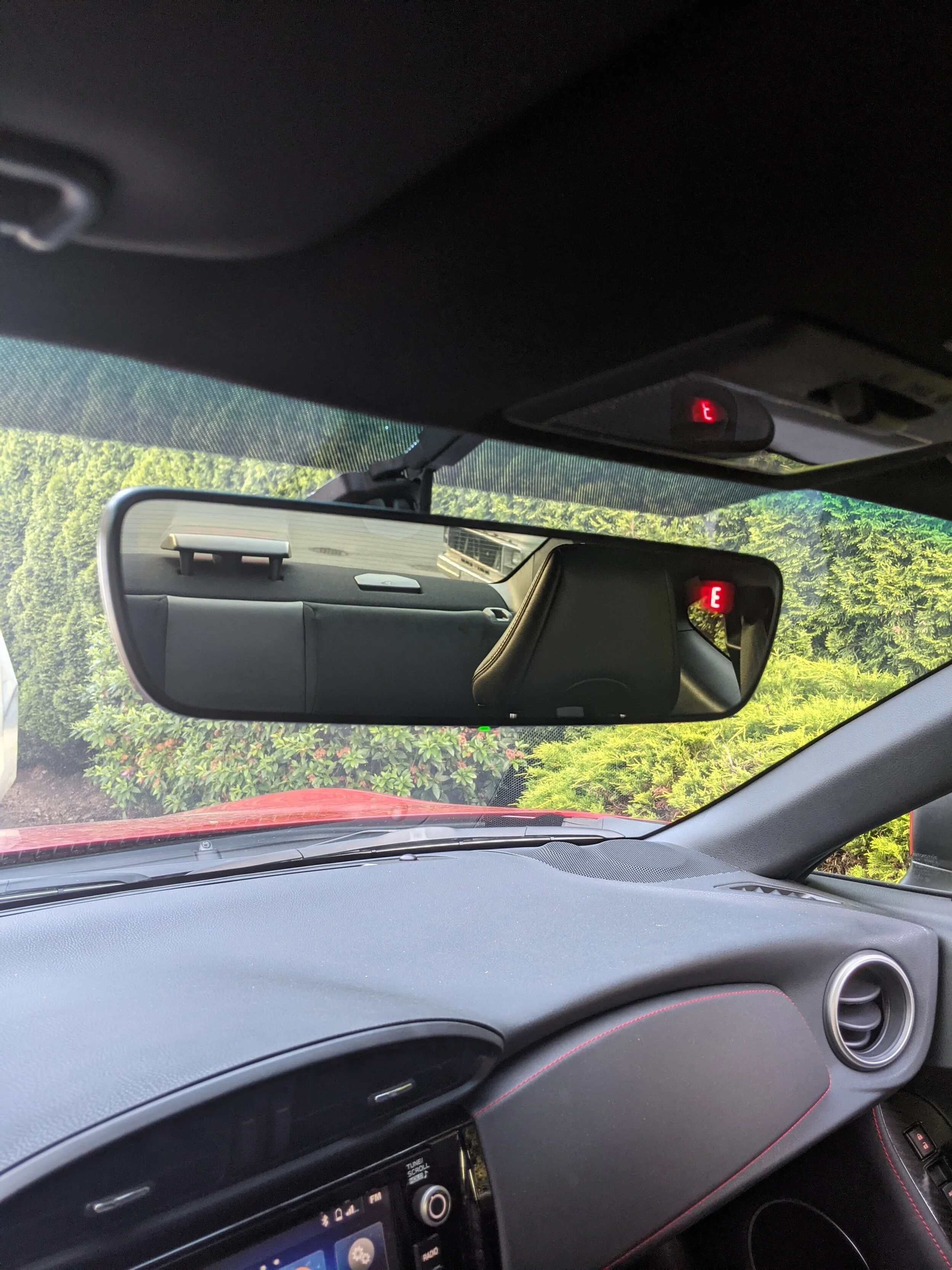

Latest mod - installed the auto-dimming mirror. This only took so long to get done because the dealer forgot to include the mounting adapter when the accessory was added to my original purchase, and then once I figured out that I had to order that, I wasn't able to pick it up from the dealer for 2-1/2 months due to COVID restrictions...LOL!
Installation was SUPER easy...
