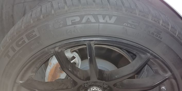

Its possible to rub depending on ride height. Look for marks or spots rubbed clean in the fender area
Do they show any weird wear? Or are one half significantly more worn then the other?
You could always change them back and see if it fixes itself.
The tires I have on now do not rub. I was asking about using a larger tire if I need to replace my current ones. The current tire I use leaves the edge of the rim exposed.
Name:  Rays Wheels.jpg
Edit: The car is stock height
Riftur is offline   Reply With Quote
Attachment 171498
Check to see if the fronts have significantly less tread then the rears. You said it had been a while before rotating so it's possible. Multiple users on the forum (myself included) have had issues with TC when replacing only 2 tires. We think the difference may screw with the electronics somehow.
Riftur (10-11-2018)
