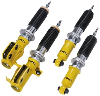

Experience with TRD springs?
Originally Posted by gpvecchi View Post
US TRD springs are Eibach Pro kit.
Are they?
The spring rates on our spring options chart don't match:
SPRINGS. Front/Rate Rear/Rate Part #
Eibach Pro-Kit 1.0"/3.6k 1.0"/4.9. 8210.5.140
TRD. 0.6"/3.5k 0.6"/5.8k MS260-18001
http://www.ft86club.com/forums/showthread.php?t=8739
Edit: looks like those are the coilovers
MS260-18001
Eibach 8210.5.140 and TRD PTR07-18130 sure look like the same springs, number of coils and locations of the progressive area are the same:
