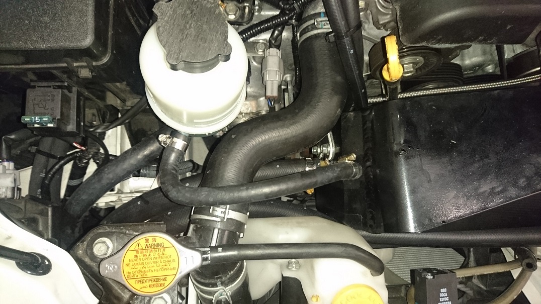

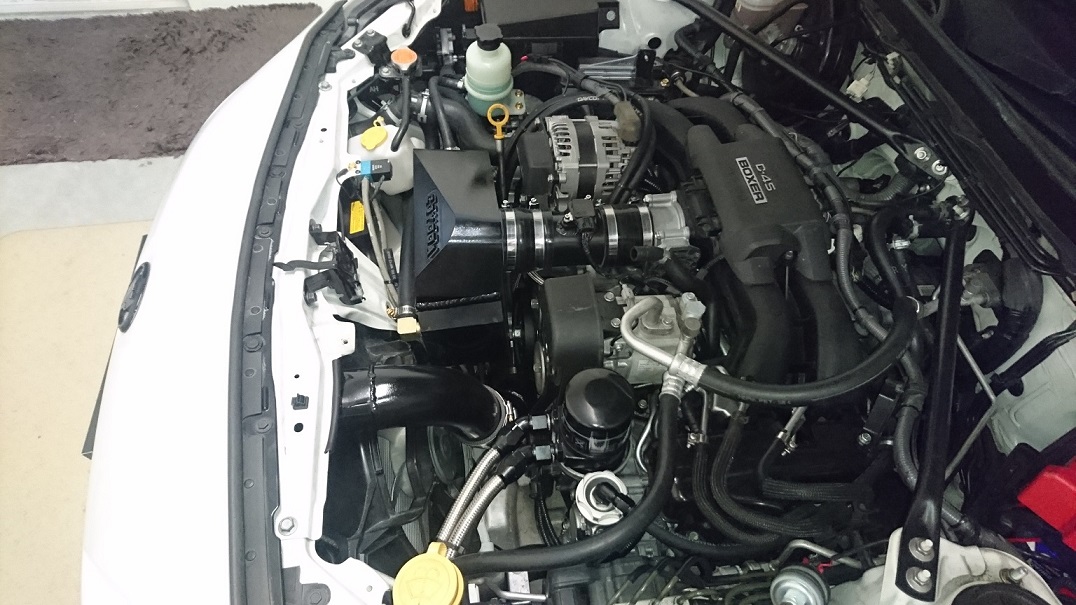

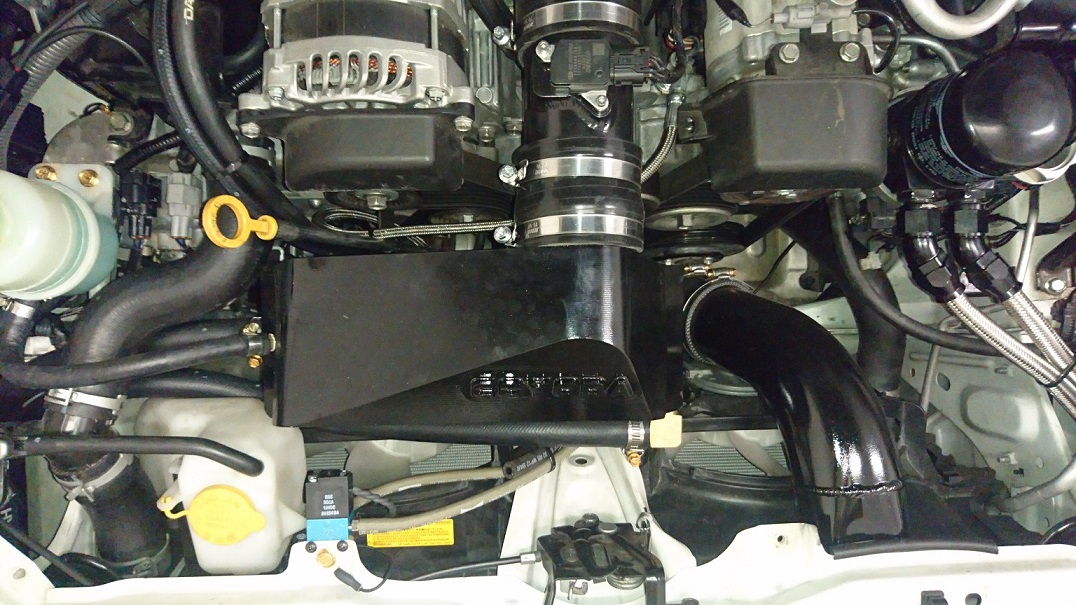

Few Pics. Let me know if you want to see something in particular will try and get what I can its just a really sneaky kit hard to see anything!

Any pictures of this kit before it was installed ?
Hey mate no sorry . Alot of this was custom and it was at one shop then moved to the shop that installed it later on not by me
https://www.facebook.com/Coyoda-Tech...8712071630836/
Has a few more pictures of stuff but there being a bit slack on updating it!
sorry.

Found this one on there site showing how the turbo sits.

So the air filter sits inside the front bumper?
I thought i saw the stock airbox in the facebook shots?
Hey Mate,
Yeah it now does. The older version used the stock air box. But they had alot of issues with clearance for the oil cooler lines for ppl and just general access to the engine bay round it was alot tighter. With the new way its just so much more room.
