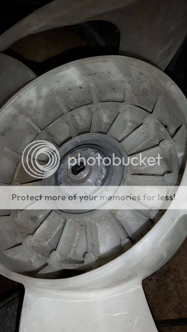

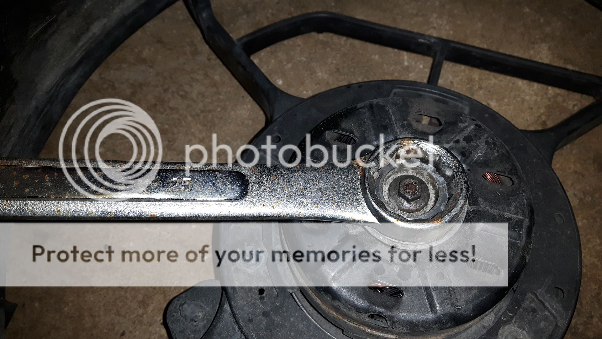

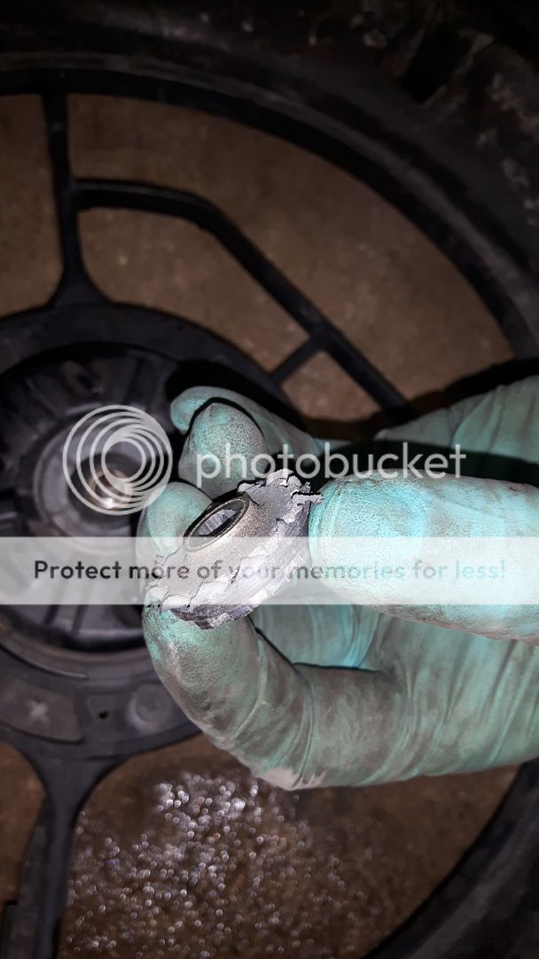

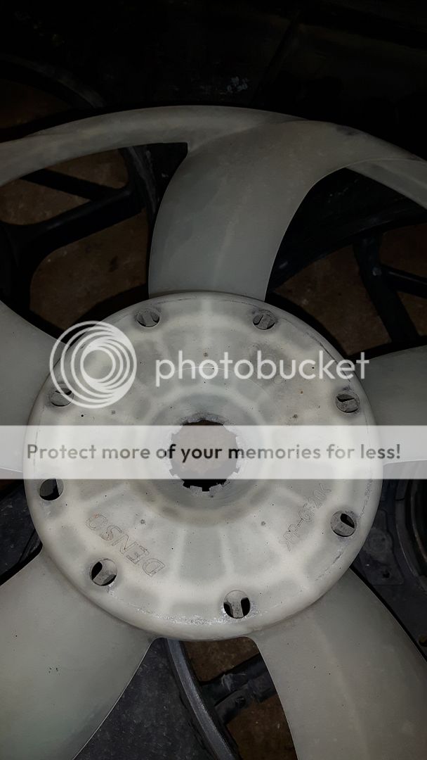

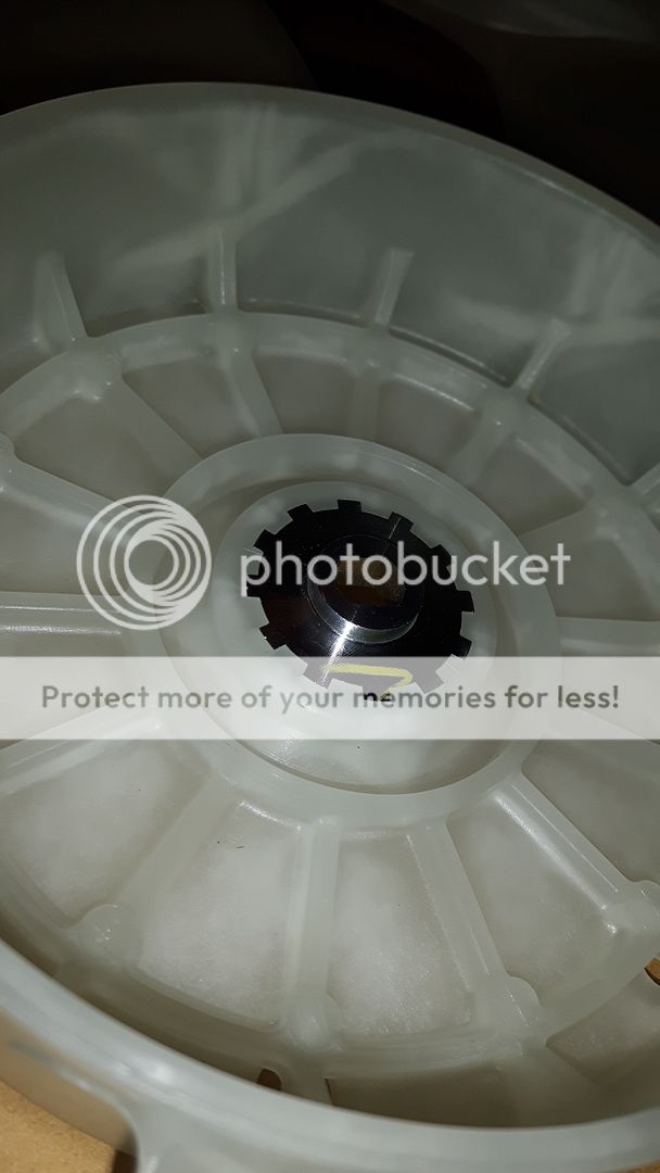

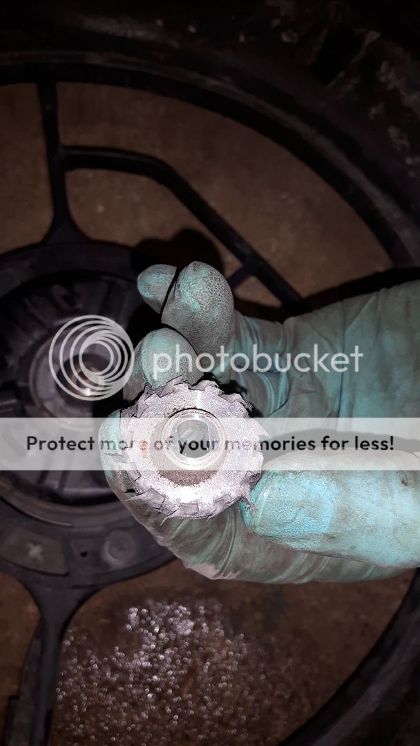

Finally as I thought the fans motors
working well.
only 2 fans was broken (2x 31$ each).
Here are pictures of the broken fans:
The center have not the same size (height):

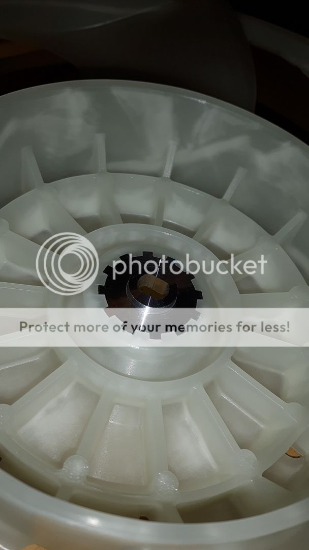

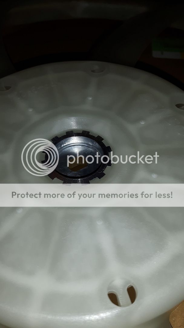

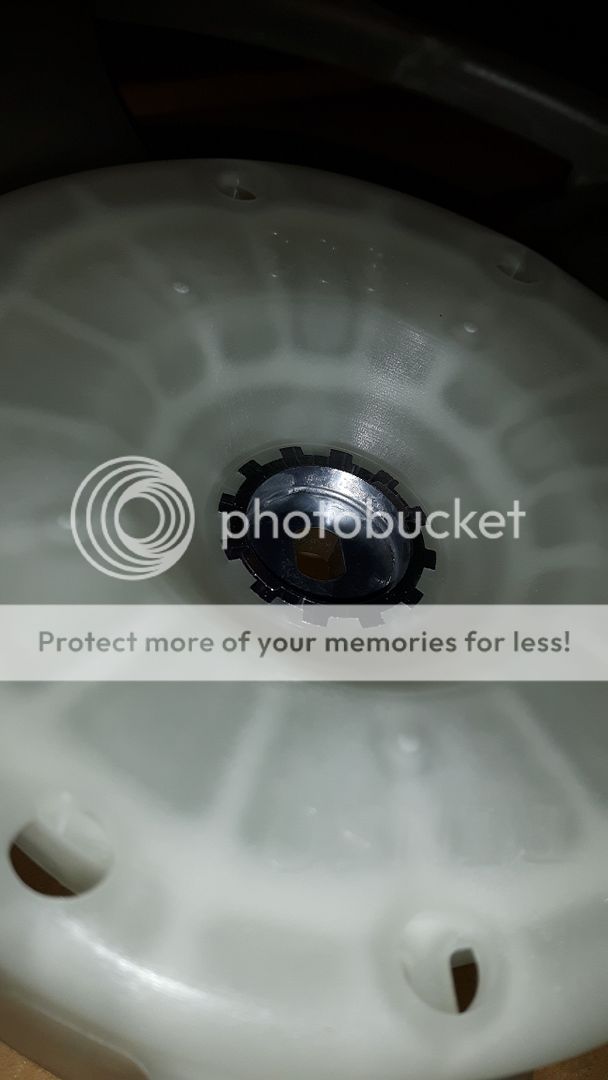

Here are pictures of the new fans:

Any visible signs that they may have hit something? I see a black mark in the top left corner of your pic that may be an impact. Of course it could also be from them wobbling but there could be a larger mark someplace. Pretty hard for something to get up in there for them to hit but not impossible.
This one still intrigues me since both went the same way at the same time and that is a rare occurrence in an equipment failure.

No hit or impact, Juste a heavy scrape (the fan fall on turning)
& scrape on Rad

stripped because of the retaining something ?!?
retained by the ice ?!?

Wouldn't think so. If just held solid the electric motors wouldn't have enough start up torque to even move. Would probably just blow a fuse. The only way I can see is if the fans were both suddenly stopped by something blocking the blades but that should have left ovious Impact marks. I am truely baffled but don't want to go jamb something in my fans to find out.

I'll hazard a guess. Fatigue failure from running out of balance.
I kind of like that theory.
Do the fan shafts run true.. ??
If not, that would show up when you put the new blades on.
Like Tcoat mentioned, both going out at the same time puzzles me.
Were you "hot rodding" the fans ??......

Aw hell, I don't know. Maybe one cracked slowly and finally failed. Then it collided with the second one and took it out.
Well, now that sounds reasonable ......
Too bad we will never know ........
