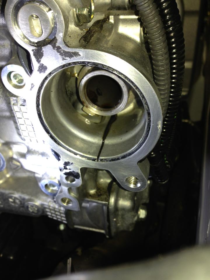

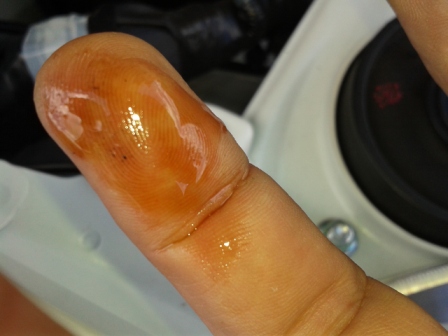

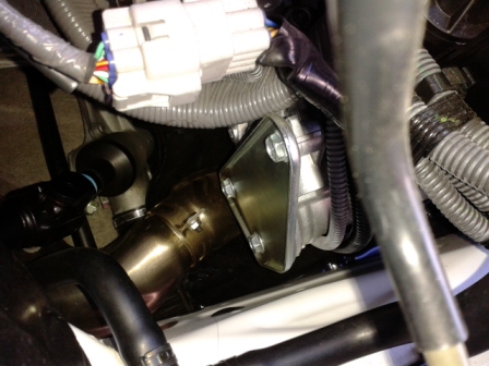

I totally agree with the fix for this problem as shown in @Cade01 picture above. Mine was sealed up twice (plate only) and still leaked. The leak is definately coming from the bottom seam of that housing shown and NOT the plate itself. It runs along the bottom and collects at the plate before dripping onto the hot exhaust. Mine has been sealed a 3rd time, but this time the housing was done too. Problem fixed!!
Pic 1: Here is what is behind the plate. although the sealant along that bottom seam looks good. It isn't!
Pic 2: The plate.
Pic 3: The amount of oil that come out after a normal days driving.

[QUOTE=Tech;1057494]
Are you saying that there is a seam inside the housing where that stream of oil is in your Pic #1? And you applied sealant where? To the inside or the outside? Outside, right?
Just want to be clear.
Thanks.

[quote=Marrk;1061238]
Thanks.
Look at the picture I posted 5 posts above yours. I circled the part that needs to be removed and sealed, you can even see the sealant the dealership put on it.

@Marrk Yes that black line which you think is a trail of oil is not. that is a line of sealant that is along the bottom seam. If you look up top, you will see another line of sealant on the outside of the housing. If you enlarge the picture you can see the seam of the two halves if you look closely.
