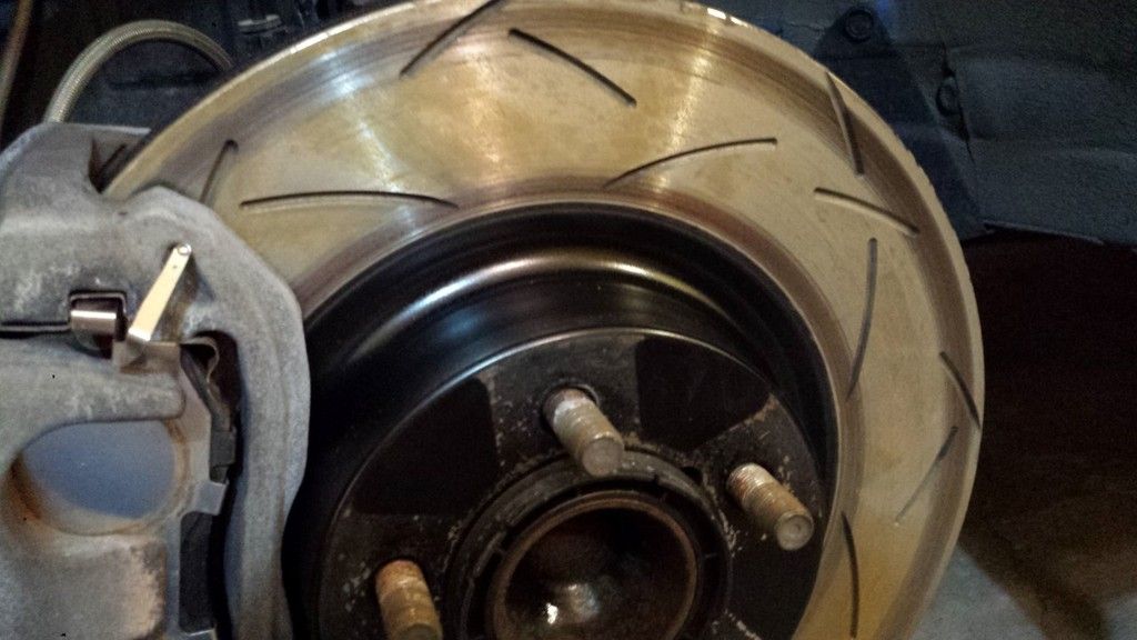

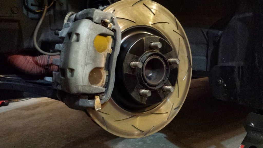

Question on DBA T3 rotors. Installed them a week ago and it's been fine, but I've noticed some pretty serious discoloration all of a sudden today. Might be surface rust, not sure yet. But man...it's pretty bad. I drive the car daily, and took it to work and back. Pulled the wheels off to start my JR Oil Cooler install and saw this. Seems odd. This is with the OEM pads, I keep the Carbotechs for track only. These babies were super bright and shiny yesterday.
Your thoughts?
I'll get better photos with my DSLR if necessary. Thanks!

Looks like surface rust. Also looks like the pads are not perfectly mated to the rotor surface, since one is new and the other is not.
Just keep driving and they'll eventually mate themselves.
-Mike

I drove the car home, walked inside and changed clothes, and then took the wheels off. I've never seen surface rust develop so fast. The back rotors (OEM) are fine.
The pads not mated to the surface of the rotors yet accelerates surface rust? Sorry if this is pretty basic. Road america in a week and a half and in a scramble to get everything done in time.
