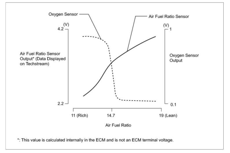

This car is equipped with a narrow band sensor.. Not wideband
The primary 02 sensor is a denso Planar Type Wide Range Air Fuel Sensor. It does not read as far on the rich side as a true wideband (10:1 to 20:1) but it is more than sufficient range for NA tuning (12.1 - 18).

I would call the OEM sensor a narrow wide band sensor, haha. Any chance one of the BRZedit users could make a video of doing things in BRZedit? Like simply showing how you open a ROM change something in the fuel or igntion tables, save the ROM, and flash the ECU.

I agree that the OEM front O2 sensor, the limiting-current type Denso A/F sensor, does not have the same range as a Bosch LSU pump-cell type. For applications where you don't need to go super rich (basically, non-boosted) it will still read accurately. Now if the front o2 sensor output the same style signal as the rear o2 sensor (oscillating 0-1v), then you could easily call them both narrowbands.
Use the right tool for the job, that's all.

They're normally referred to as a 'lean burn' sensor, with much more resolution and range on the leaner side of stoich. Similar to the NTK L1H1 type stuff.
